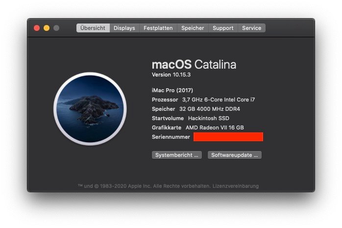

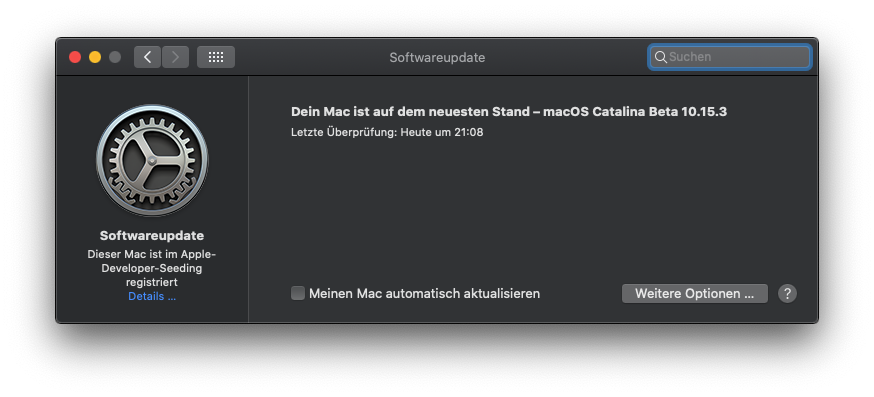

Ich danke allen Beta-testern hier - ich bleibe momentan noch auf der 15.3, da gerade alles funktioniert was ich benötige

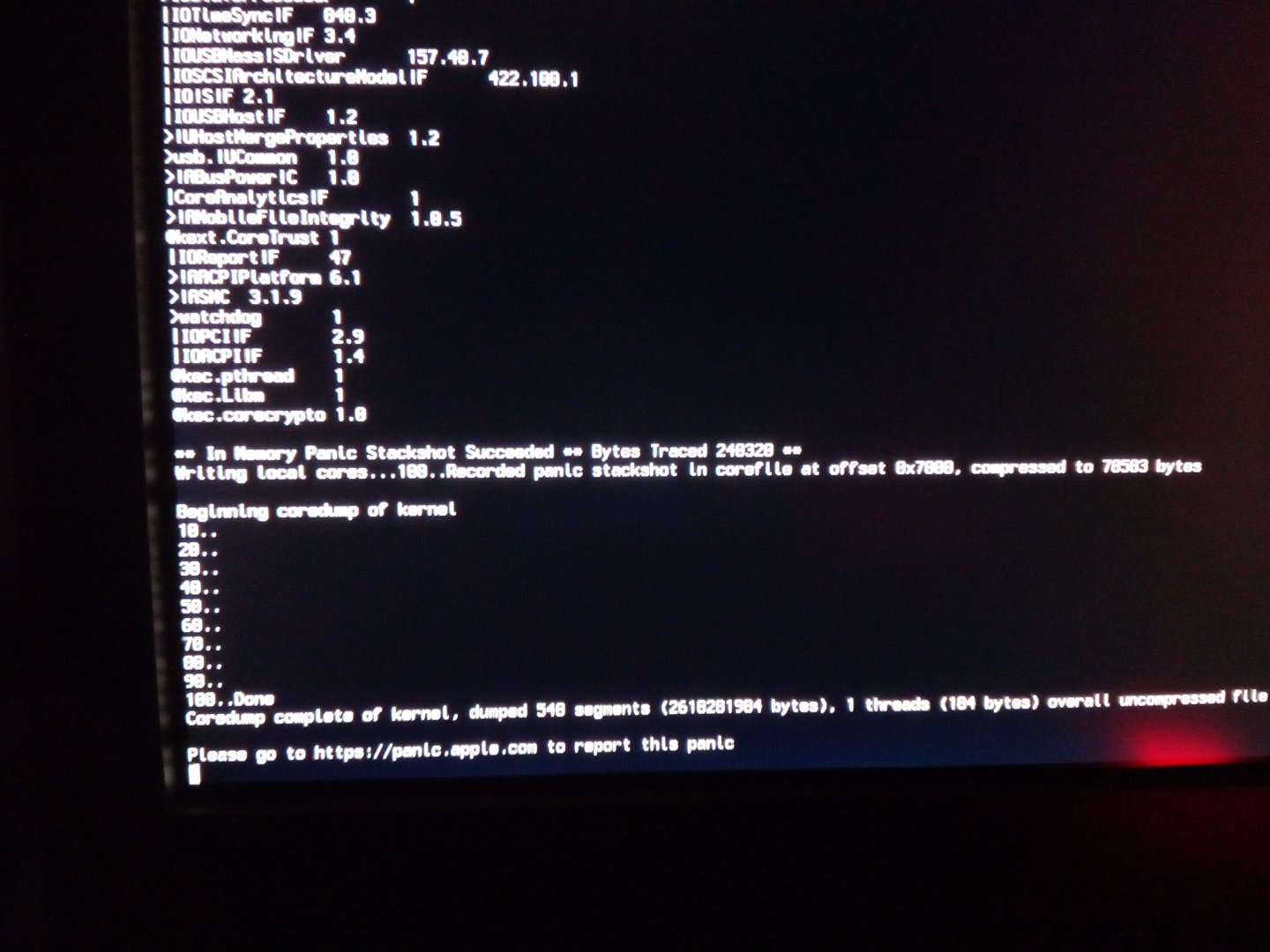

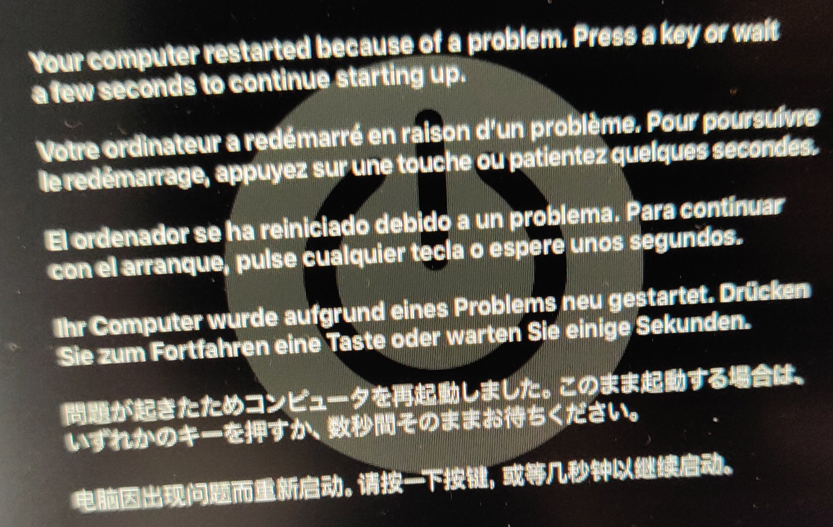

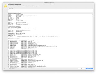

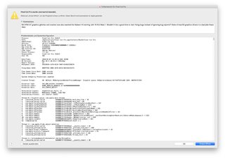

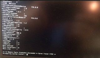

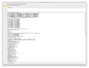

Super, Apple. Logic 10.5 raucht schön regelmäßig nun ab in 10.15.6 PB1. Kann jemand mit dem Error-Log etwas anfangen?
Alles anzeigenCode- mp_kdp_enter() timed-out on cpu 2, NMI-ing
- mp_kdp_enter() NMI pending on cpus: 0 10 11
- mp_kdp_enter() timed-out during locked wait after NMI;expected 16 acks but received 14 after 12300228 loops in 1800000000 ticks
- panic(cpu 2 caller 0xffffff80148241bb): "IPI timeout, unresponsive CPU bitmap: 0xc00, NMIPI acks: 0x0, now: 0x0, deadline: 738565115079, pre-NMIPI time: 0xabf5e94d5e, current: 0xac13b6b3aa, global: 0"@/AppleInternal/BuildRoot/Library/Caches/com.apple.xbs/Sources/xnu/xnu-6153.140.21/osfmk/x86_64/pmap.c:2909
- Backtrace (CPU 2), Frame : Return Address
- 0xffffffa774fa38a0 : 0xffffff801471d5cd mach_kernel : _handle_debugger_trap + 0x49d
- 0xffffffa774fa38f0 : 0xffffff8014857545 mach_kernel : _kdp_i386_trap + 0x155
- 0xffffffa774fa3930 : 0xffffff80148490fe mach_kernel : _kernel_trap + 0x4ee
- 0xffffffa774fa3980 : 0xffffff80146c3a40 mach_kernel : _return_from_trap + 0xe0
- 0xffffffa774fa39a0 : 0xffffff801471cc97 mach_kernel : _DebuggerTrapWithState + 0x17
- 0xffffffa774fa3aa0 : 0xffffff801471d087 mach_kernel : _panic_trap_to_debugger + 0x227
- 0xffffffa774fa3af0 : 0xffffff8014ec11ec mach_kernel : _panic + 0x54
- 0xffffffa774fa3b60 : 0xffffff80148241bb mach_kernel : _pmap_flush_tlbs + 0x83b
- 0xffffffa774fa3c10 : 0xffffff8014829eb2 mach_kernel : _pmap_remove_range_options + 0x3a2
- 0xffffffa774fa3cf0 : 0xffffff801482ac46 mach_kernel : _pmap_remove_options + 0x1f6
- 0xffffffa774fa3d50 : 0xffffff80147b69e5 mach_kernel : _vm_map_destroy + 0x8d5
- 0xffffffa774fa3ea0 : 0xffffff80147be3be mach_kernel : _vm_map_remove + 0x5e
- 0xffffffa774fa3ed0 : 0xffffff801470eb9e mach_kernel : __kernelrpc_mach_vm_deallocate_trap + 0x7e
- 0xffffffa774fa3f00 : 0xffffff801482ed35 mach_kernel : _mach_call_munger64 + 0x205
- 0xffffffa774fa3fa0 : 0xffffff80146c4226 mach_kernel : _hndl_mach_scall64 + 0x16
- BSD process name corresponding to current thread: Logic Pro X
- Boot args: keepsyms=1 shikigva=80 agdpmod=pikera
- Mac OS version:
- 19G36e
- Kernel version:
- Darwin Kernel Version 19.6.0: Sun May 17 22:15:23 PDT 2020; root:xnu-6153.140.21~10/RELEASE_X86_64
- Kernel UUID: 052619C0-59E2-3B32-BCCF-AEFB3E68DE47
- Kernel slide: 0x0000000014400000
- Kernel text base: 0xffffff8014600000
- __HIB text base: 0xffffff8014500000
- System model name: iMac19,1 (Mac-AA95B1DDAB278B95)
- System shutdown begun: NO
- Panic diags file available: YES (0x0)
- System uptime in nanoseconds: 740065539333
- last loaded kext at 132388241030: @filesystems.smbfs 3.4.3 (addr 0xffffff7f97794000, size 454656)
- loaded kexts:
- at.obdev.nke.LittleSnitch 5474
- as.acidanthera.mieze.!IMausi 1.0.2
- ru.joedm.SMCSuperIO 1.1.4
- as.vit9696.SMCProcessor 1.1.4
- as.vit9696.VirtualSMC 1.1.4
- as.vit9696.!AALC 1.5.0
- as.vit9696.WhateverGreen 1.4.0
- as.vit9696.Lilu 1.4.5
- @filesystems.smbfs 3.4.3
- >!ATopCaseHIDEventDriver 3430.1
- @fileutil 20.036.15
- @filesystems.autofs 3.0
- >!APlatformEnabler 2.7.0d0
- >AGPM 111.4.4
- >X86PlatformShim 1.0.0
- >!AUpstreamUserClient 3.6.8
- >!AMCCSControl 1.14
- >!AHDAHardwareConfigDriver 283.15
- >!AHDA 283.15
- @kext.AMDRadeonX6000 3.1.0
- @kext.AMDRadeonServiceManager 3.1.0
- >!AGraphicsDevicePolicy 5.2.6
- @AGDCPluginDisplayMetrics 5.2.6
- >!A!IKBLGraphics 14.0.7
- >!AHV 1
- |IOUserEthernet 1.0.1
- |IO!BSerialManager 7.0.6f3
- >pmtelemetry 1
- @Dont_Steal_Mac_OS_X 7.0.0
- >!AFIVRDriver 4.1.0
- >!A!ICFLGraphicsFramebuffer 14.0.7
- >!A!IPCHPMC 2.0.1
- >!AGFXHDA 100.1.428
- >!A!ISlowAdaptiveClocking 4.0.0
- >AudioAUUC 1.70
- >ACPI_SMC_PlatformPlugin 1.0.0
- >Core!SFsck 551
- @private.KextAudit 1.0
- |IO!BUSBDFU 7.0.6f3
- |SCSITaskUserClient 422.120.3
- >!AFileSystemDriver 3.0.1
- >!AVirtIO 1.0
- @filesystems.hfs.kext 522.100.5
- @!AFSCompression.!AFSCompressionTypeDataless 1.0.0d1
- @BootCache 40
- @!AFSCompression.!AFSCompressionTypeZlib 1.0.0
- @filesystems.apfs 1412.120.2
- >AirPort.BrcmNIC 1400.1.1
- >!AAHCIPort 341.0.2
- >!AACPIButtons 6.1
- >!ARTC 2.0
- >!AHPET 1.8
- >!ASMBIOS 2.1
- >!AAPIC 1.7
- $!AImage4 1
- @nke.applicationfirewall 303
- $TMSafetyNet 8
- @!ASystemPolicy 2.0.0
- |EndpointSecurity 1
- >!AMultitouchDriver 3440.1
- >!AInputDeviceSupport 3440.8
- >!AHS!BDriver 3430.1
- >IO!BHIDDriver 7.0.6f3
- @kext.triggers 1.0
- >!ASMBus!C 1.0.18d1
- |IOSMBus!F 1.1
- >DspFuncLib 283.15
- @kext.OSvKernDSPLib 529
- @kext.AMDRadeonX6000HWLibs 1.0
- @kext.AMDRadeonX6000HWServices 3.1.0
- >!AGraphicsControl 5.2.6
- |IOAVB!F 850.1
- >!AHDA!C 283.15
- |IOHDA!F 283.15
- @kext.AMDRadeonX6000Framebuffer 3.1.0
- |IOAccelerator!F2 438.7.1
- @kext.AMDSupport 3.1.0
- >!ASMBusPCI 1.0.14d1
- |IONDRVSupport 576.1
- @!AGPUWrangler 5.2.6
- @!AGraphicsDeviceControl 5.2.6
- |IOSlowAdaptiveClocking!F 1.0.0
- @plugin.IOgPTPPlugin 840.3
- |IOEthernetAVB!C 1.1.0
- |IOGraphics!F 576.1
- >IOPlatformPluginLegacy 1.0.0
- >X86PlatformPlugin 1.0.0
- >IOPlatformPlugin!F 6.0.0d8
- >Core!S 551
- |Broadcom!BHost!CUSBTransport 7.0.6f3
- |IO!BHost!CUSBTransport 7.0.6f3
- |IO!BHost!CTransport 7.0.6f3
- |IO!B!F 7.0.6f3
- |IO!BPacketLogger 7.0.6f3
- >usb.IOUSBHostHIDDevice 1.2
- >usb.!UHub 1.2
- >!UAudio 323.1
- >usb.cdc 5.0.0
- >usb.networking 5.0.0
- >usb.!UHostCompositeDevice 1.2
- >!UMergeNub 900.4.2
- |IOAudio!F 300.2
- @vecLib.kext 1.2.0
- |IOSerial!F 11
- |IOSurface 269.11
- @filesystems.hfs.encodings.kext 1
- >!AXsanScheme 3
- >usb.!UHostPacketFilter 1.0
- |IONVMe!F 2.1.0
- |IOUSB!F 900.4.2
- |IOAHCIBlock!S 316.100.5
- |IO80211!F 1200.12.2b1
- >mDNSOffloadUserClient 1.0.1b8
- >corecapture 1.0.4
- >!AEFINVRAM 2.1
- |IOSkywalk!F 1
- |IOAHCI!F 290.0.1
- >usb.!UXHCIPCI 1.2
- >usb.!UXHCI 1.2
- >!AEFIRuntime 2.1
- |IOHID!F 2.0.0
- $quarantine 4
- $sandbox 300.0
- @kext.!AMatch 1.0.0d1
- >DiskImages 493.0.0
- >!AFDEKeyStore 28.30
- >!AEffaceable!S 1.0
- >!ASSE 1.0
- >!AKeyStore 2
- >!UTDM 489.120.1
- |IOSCSIBlockCommandsDevice 422.120.3
- >!ACredentialManager 1.0
- >KernelRelayHost 1
- >!ASEPManager 1.0.1
- >IOSlaveProcessor 1
- |IOUSBMass!SDriver 157.140.1
- |IOSCSIArchitectureModel!F 422.120.3
- |IO!S!F 2.1
- |IOUSBHost!F 1.2
- >!UHostMergeProperties 1.2
- >usb.!UCommon 1.0
- >!ABusPower!C 1.0
- |CoreAnalytics!F 1
- >!AMobileFileIntegrity 1.0.5
- @kext.CoreTrust 1
- |IOTimeSync!F 840.3
- |IONetworking!F 3.4
- |IOReport!F 47
- >!AACPIPlatform 6.1
- >!ASMC 3.1.9
- >watchdog 1
- |IOPCI!F 2.9
- |IOACPI!F 1.4
- @kec.pthread 1
- @kec.corecrypto 1.0
- @kec.Libm 1

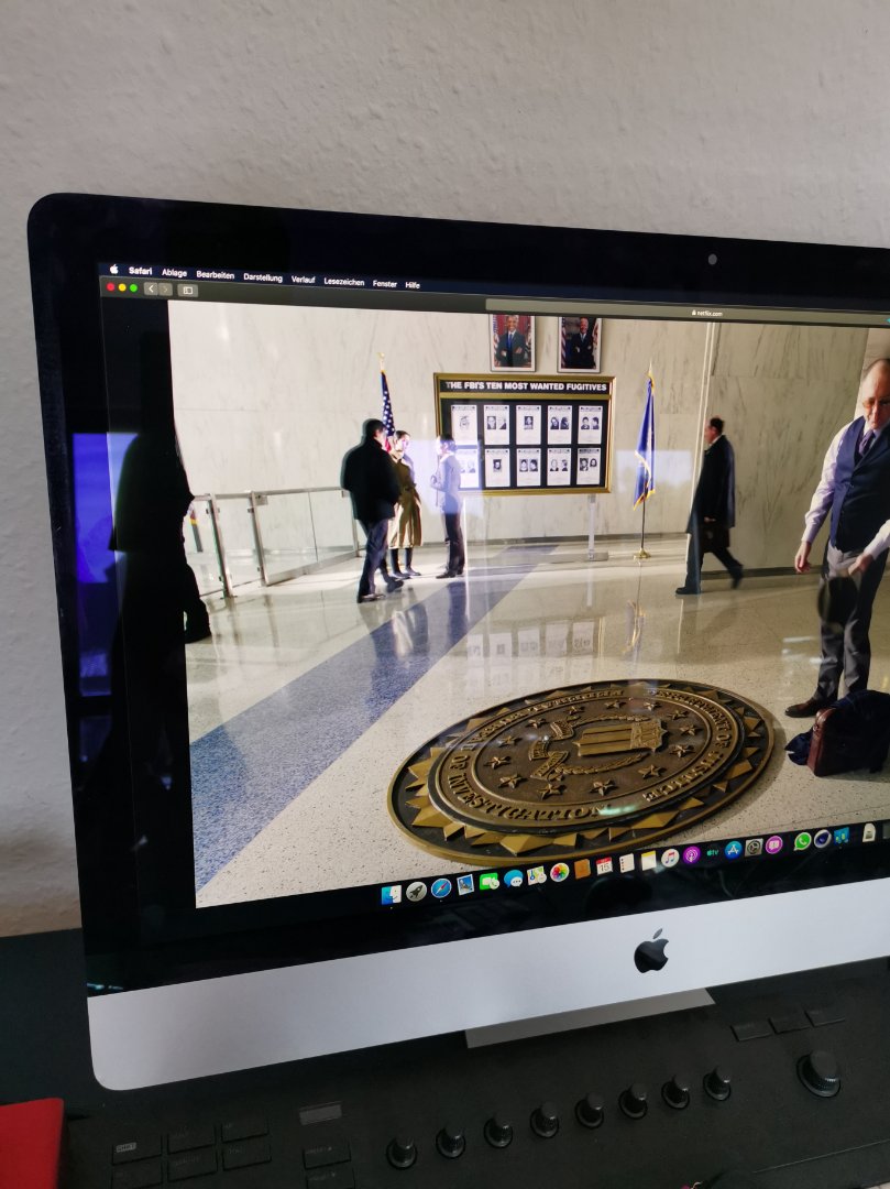

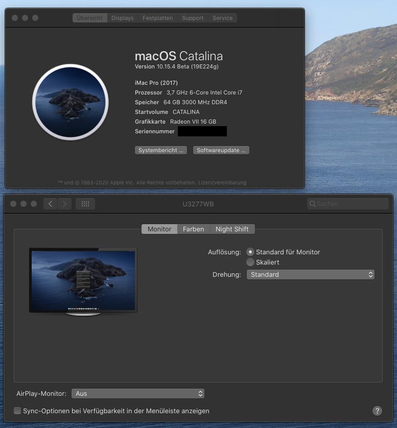

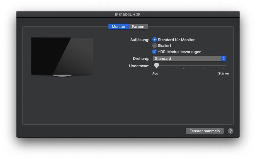

So mal ne kurze Rückmeldung meinerseits. Also auf Hell gestellt und dann Mission Control so hin und herr aber keine Artefakte. EgaL WIE EXESSIV ICH DAS MACHE. Kann ich diesbezüglich nicht bestätigen. Frühere DEV Betas liessen um Dunkelmodus Glitches und Artefakte auftreten. Im Hell aber nicht. Und was Grafik Fehler angeht hab ich einfach keine zur Zeit. Kann nicht sagen woran es liegt. Aber einreden scheint auch nichts zu bringen. Würde gerade behaupten läuft relativ geschmeidig bis auf minimalste Temperatur Schwankung nach oben seit der jetzigen Beta.
Wobei ich zumindest am C621 Hackintosh sagen muss, dass ich aus welchen Gründen auch immer, noch keine Fehlerberichte/Abstürze und dergleichen gehabt habe mit 10.15.6 Beta 1.
Sehr Strange...

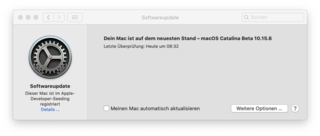

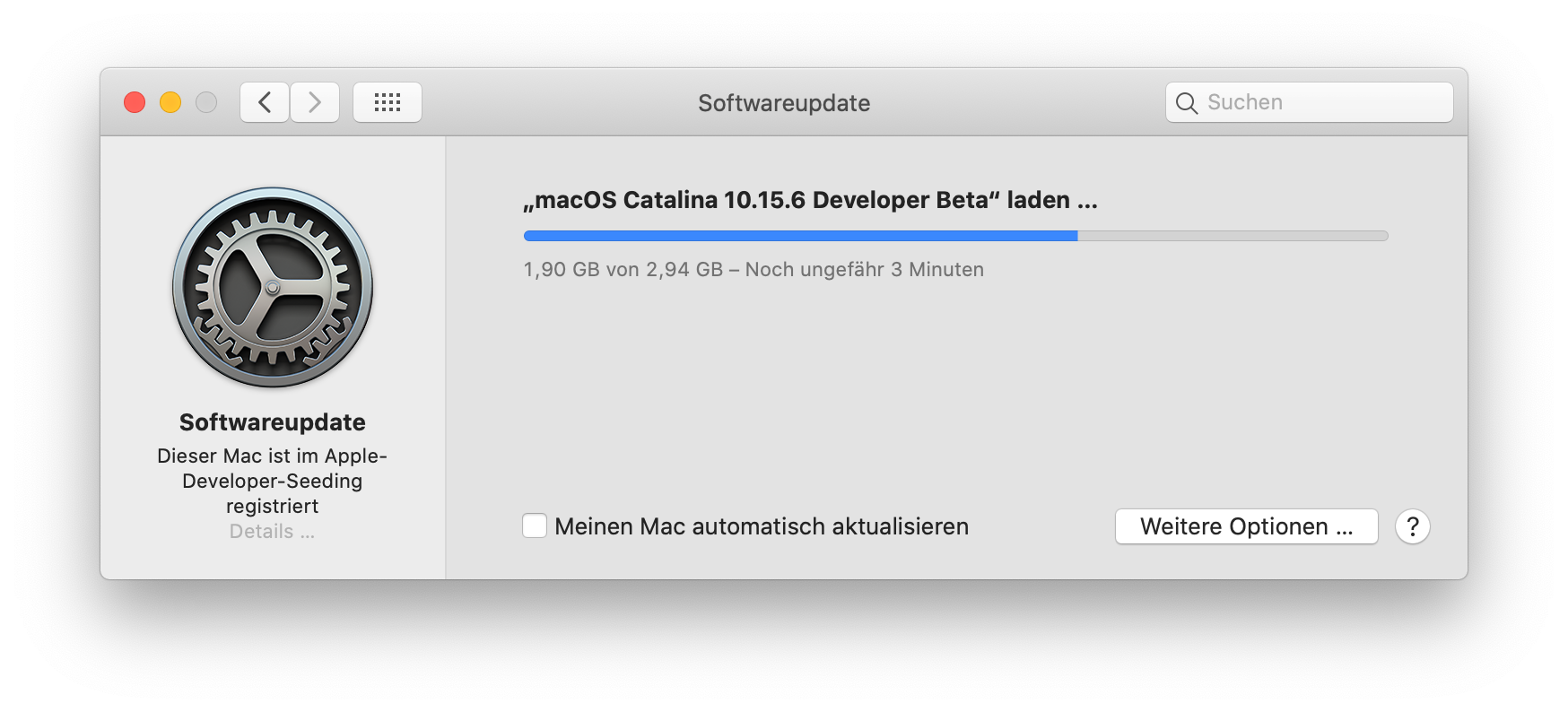

Sauber durchgegangen Beta 2! Keine Aussetzer oder negative Auffälligkeiten. Darf gerne so bleiben...
Hier ist auch alles sauber durchgelaufen mit Beta2
ich hab anscheinend die richtigen Grafikkarten..
Nicht nur anscheinend.

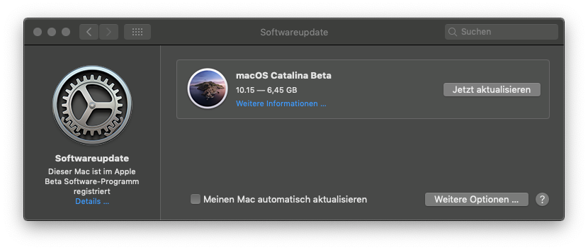

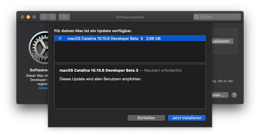

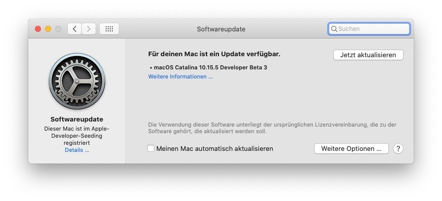

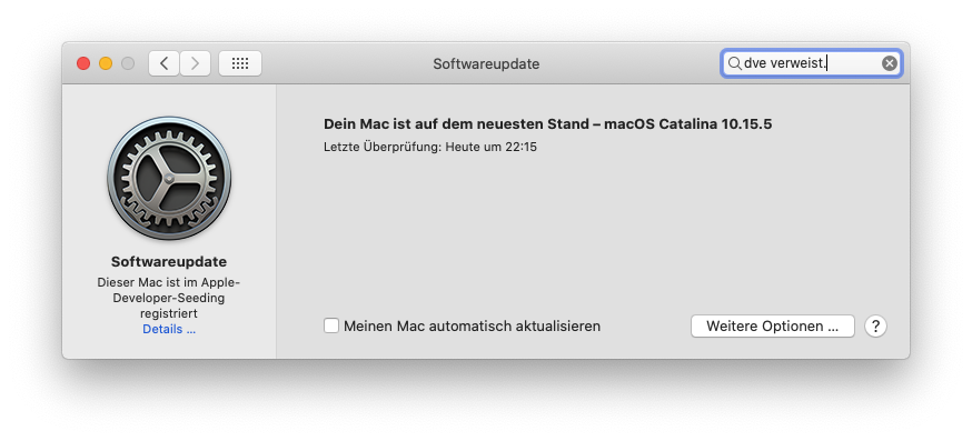

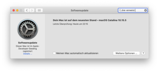

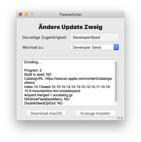

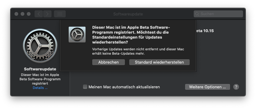

Bei mir gab es einen Unterschied zu den vorherigen Beta-Updates: bislang wurde nach einem Beta-Update der Status von Dev-Betas auf Public-Beta umgestellt und ich musste vor dem nächsten Update wieder auf Dev umstellen. Das ist diesmal nicht der Fall - der Dev-Status blieb erhalten.
@CMMChris Folgendes, sehr merkwürdiges Verhalten konnte ich beobachten:
10.15.4.1 - 10.15.5.1 ständig Freezes und Abstürze in verschiedenen Situationen
10.15.6 PB1 reproduzierbare Abstürze mit Logic X 10.5 und inline Videos in Websites
10.15.6 PB1 (Virtual)SMC in der config.plist testweise deaktiviert (Lüfter RPM wurden nicht korrekt dargestellt), keine Abstürze mehr (EFI OC 0.5.8)
10.15.6 PB2 (Virtual)SMC in der config.plist wieder aktiviert, keine Abstürze mehr (EFI OC 0.5.9) -
