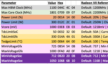

    Radeon Wattman Pendant für macOS. Die PowerPlay Table kann bequem per Clover auf den PCI Pfad der Grafikkarte injected werden. In Clover kann man statt dem PCI Pfad auch einfach "PrimaryGPU" als Target Device nehmen.

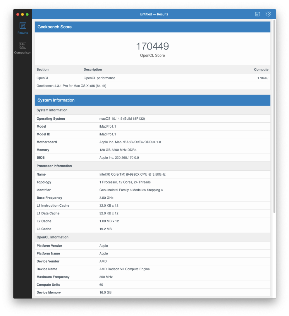

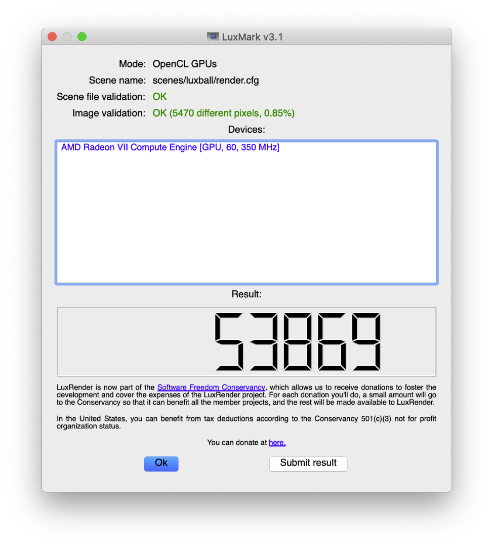

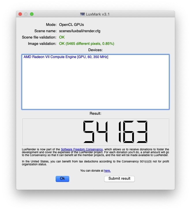

  • Erstes Overclocking Resultat per PowerPlay Table. In dem Test wurde der HBM Takt auf 1050MHz angehoben.

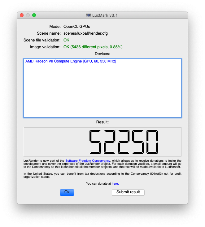

    Mein Stock Ergebnis:

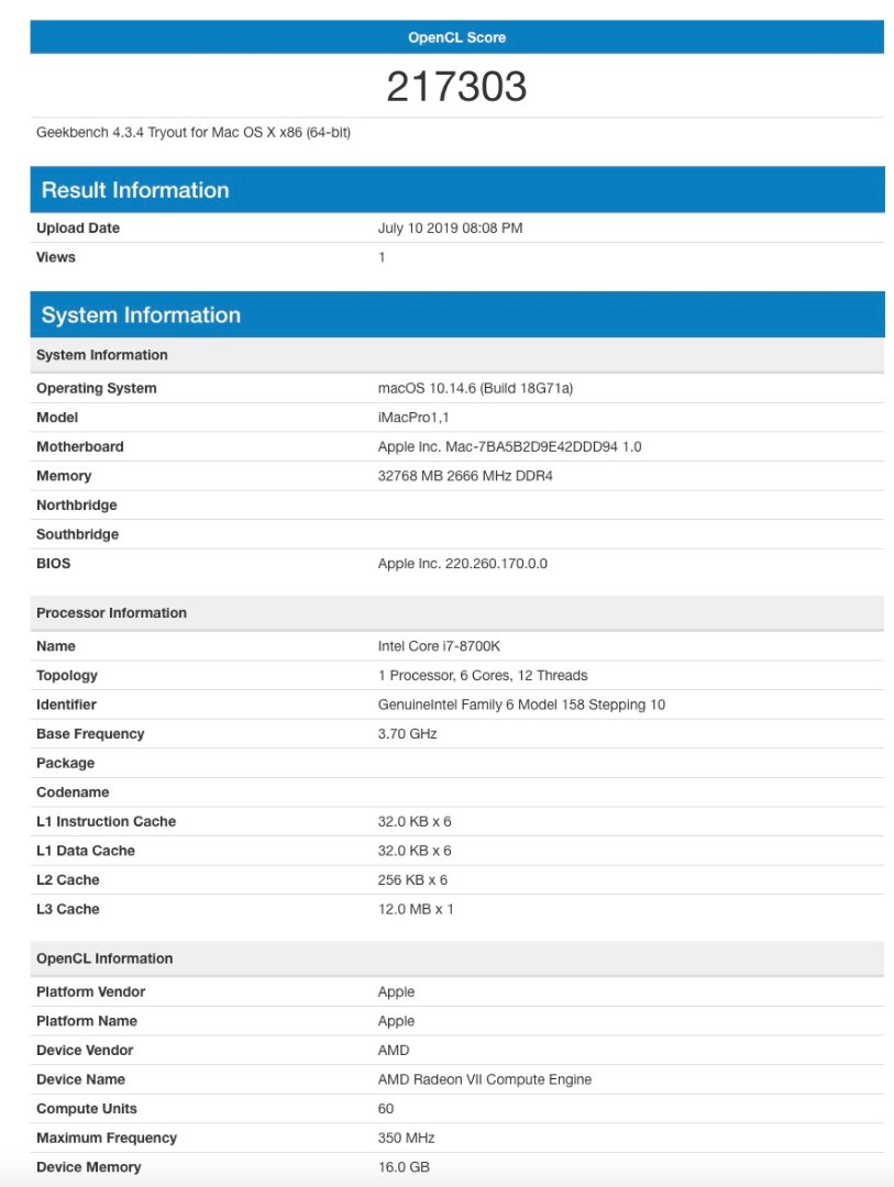

  • 10.14.6 Beta 4 / HBM 1100MHz / GPU 1849MHz
    Geekbench Problem behoben wie mir scheint?! DSM2

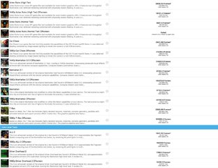

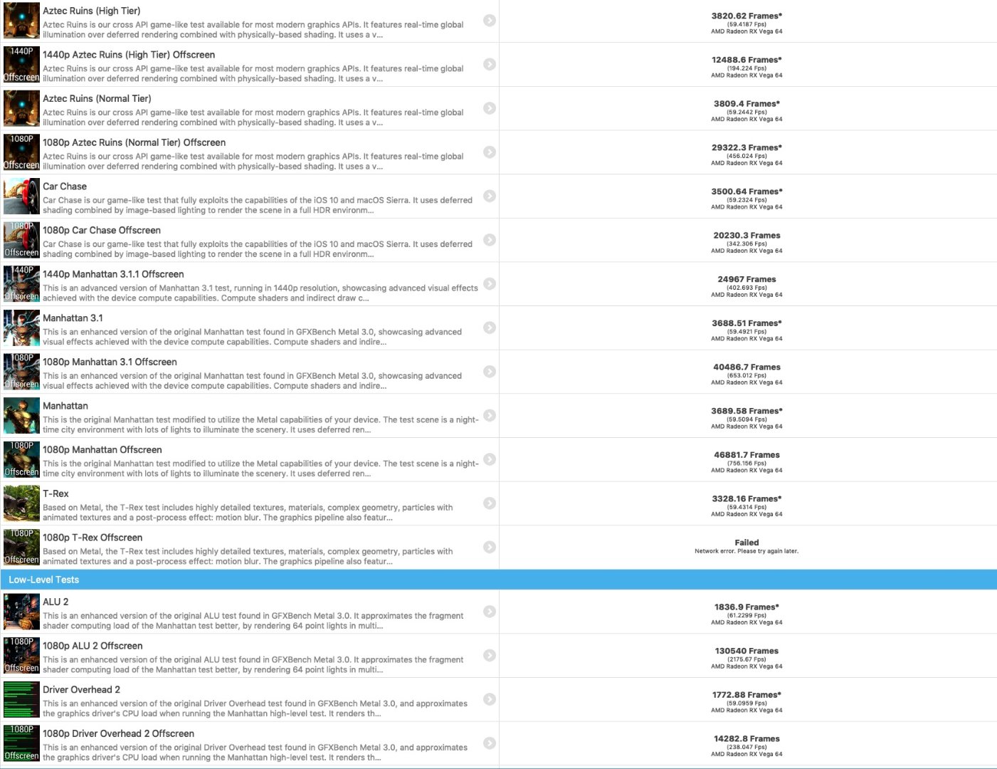

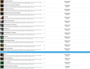

  • Jup habe ja die Settings notiert.

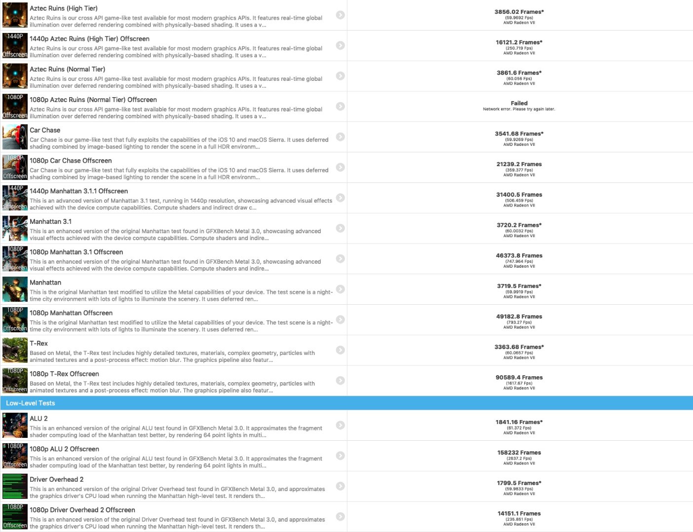

    Edit: Hier noch GFXBench Metal Resultate im Vergleich
    Radeon VII 10.14.6 B4
    Radeon VII 10.14.5 Release
    GB Vega 64 Gaming OC 10.14.5 Release
    VORERST BETEILIGE ICH MICH HIER NICHT MEHR. PER PN KÖNNT IHR MICH WEITERHIN ERREICHEN.
    LG Chris
    Meine Hardware:
    Edited once, last by CMMChris ().

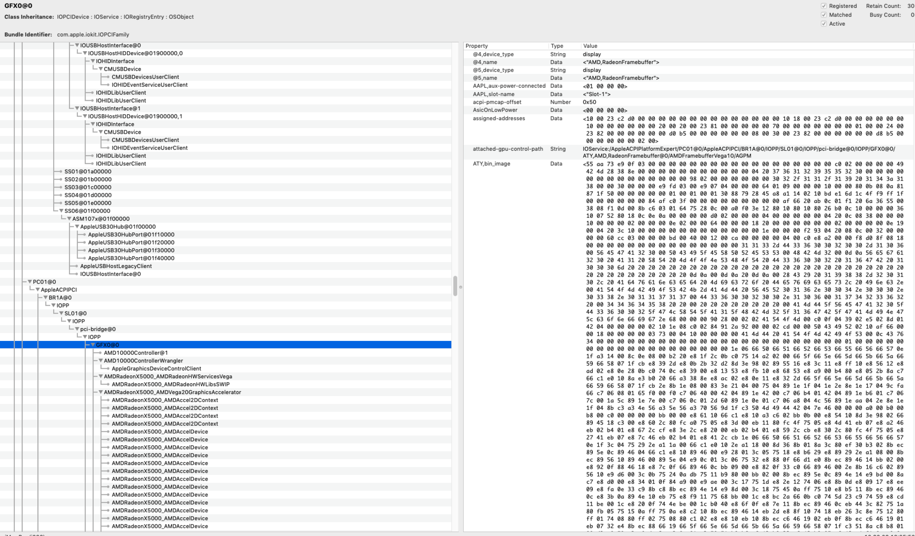

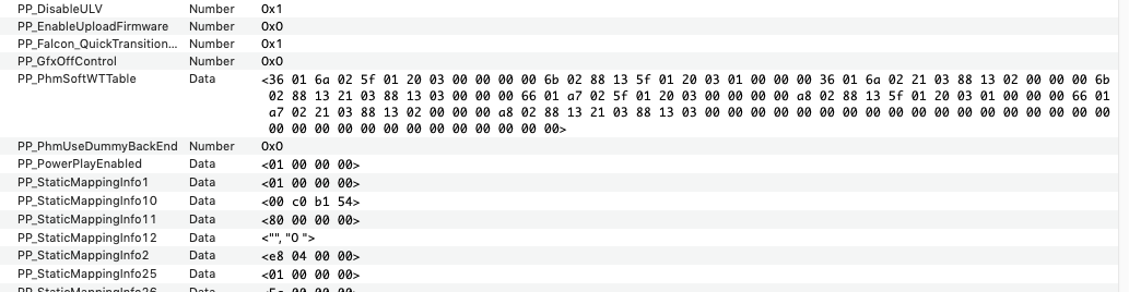

  • looks great.
    i am using Radeon VII with EK waterblock in Mojave.
    so just copy those 'Clover Output' value and paste it to Clover Device?
    thanks.

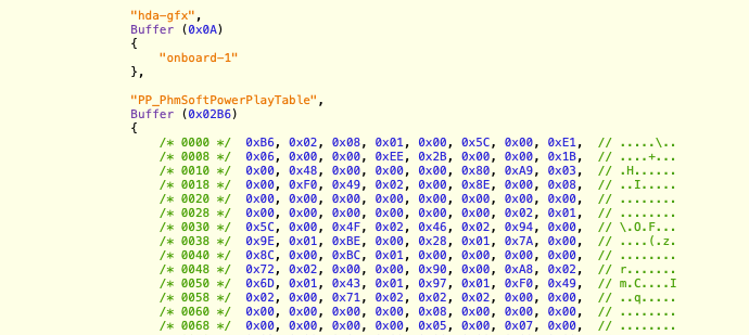

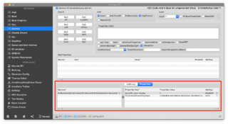

  • Yup, create a property inject on the Radeon VII PCI ID, create the property "PP_PhmSoftPowerPlayTable" as Data and paste the Clover Output. HBM clock already on maximum, going higher than 1100MHz doesn't give you any increase in scores. If you like you can increase the GPU clock for better scores. You likely won't get it that much higher tho since you cannot reduce voltage on macOS which causes a lot of heat with GPU overclocking. I am running mine air-cooled at 1849MHz right now.
    LG Chris
    Meine Hardware:
  • Yup, create a property inject on the Radeon VII PCI ID, create the property "PP_PhmSoftPowerPlayTable" as Data and paste the Clover Output. HBM clock already on maximum, going higher than 1100MHz does not give you any increase in scores. If you like you can increase the GPU clock for better scores. You probably do not get that much higher since you can not reduce the voltage on macOS which causes a lot of heat with GPU overclocking. I am running mine air-cooled at 1849MHz right now.

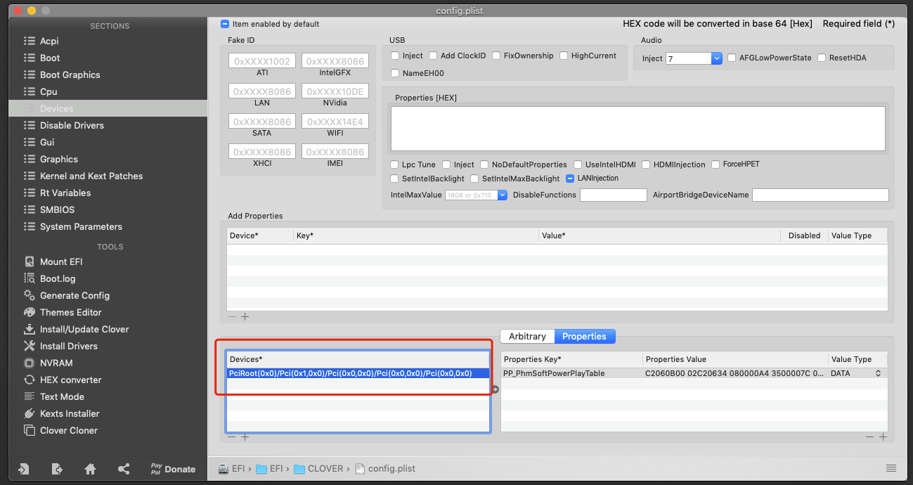

    Thanks Chris.
    But it does not work.
    may be it was caused by wrong Devices?
    i am using Asus x299 Deluxe II and Radeon VII in the first PCIE slot.
    Edited 2 times, last by iTTT ().

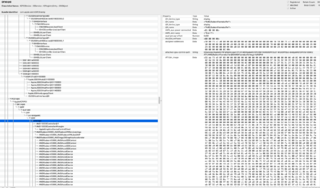

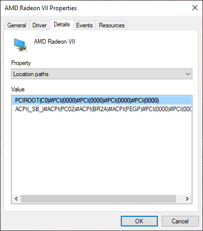

  • Use Hackintool to get the appropriate device path.
    LG Chris
    Meine Hardware:
    i searched and then used gfxutil -f gfx0 to show pci address.
    PciRoot(0x20)/Pci(0x0,0x0)/Pci(0x0,0x0)/Pci(0x0,0x0)/Pci(0x0,0x0)
    reboot and nothing change at all...so weird.
