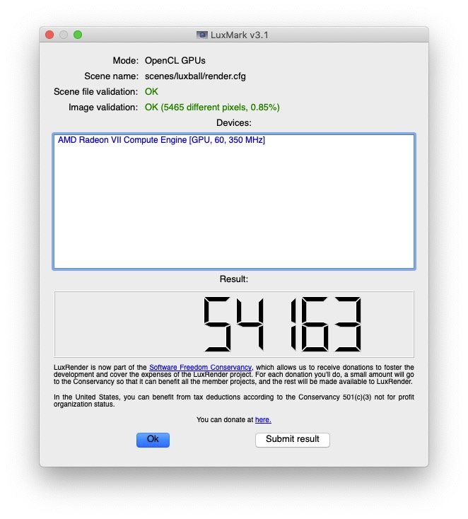

Yup, create a property inject on the Radeon VII PCI ID, create the property "PP_PhmSoftPowerPlayTable" as Data and paste the Clover Output. HBM clock already on maximum, going higher than 1100MHz does not give you any increase in scores. If you like you can increase the GPU clock for better scores. You probably do not get that much higher since you can not reduce the voltage on macOS which causes a lot of heat with GPU overclocking. I am running mine air-cooled at 1849MHz right now.
