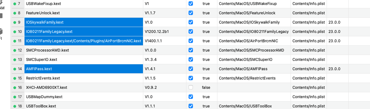

    You have to use OCLP (OpenCore legacy patcher) app (in this forum there is a guide)
    https://github.com/dortania/OpenCore-Legacy-Patcher/releases

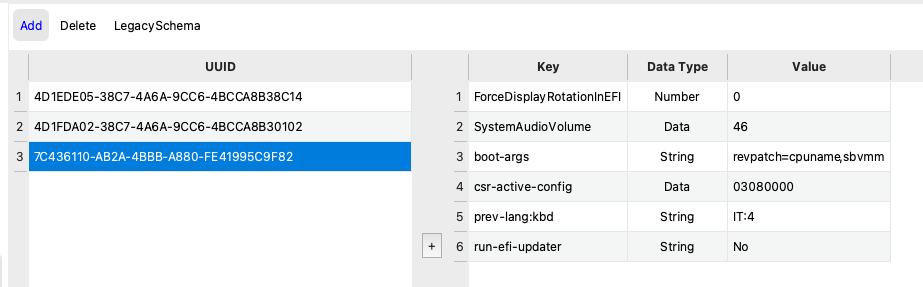

    from this github you can find also the kexts you need follow also the kexts order as my example picture.
    in short these are the steps you have to follow
    Disable sip with this value 03080000
    reboot and reset Nvram
    run OCLP and start root patching.

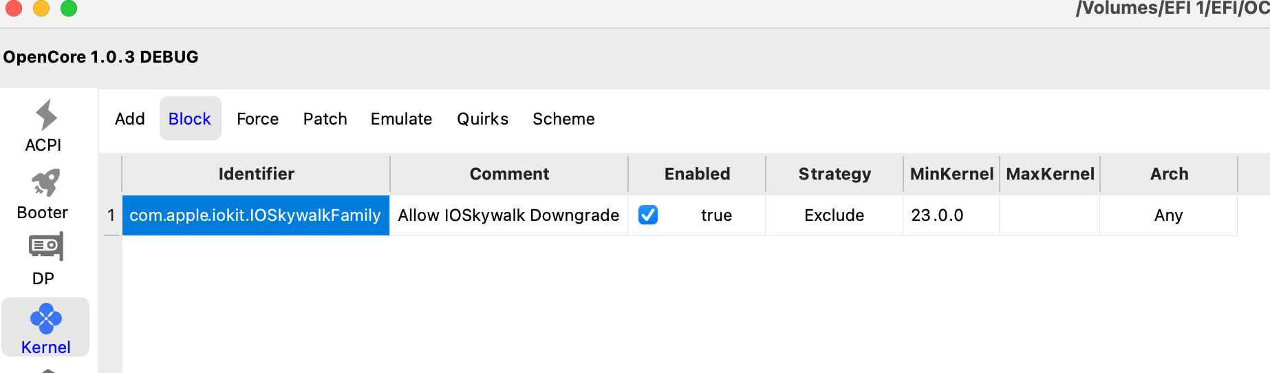

    before reboot set this :
    and these kexts:
    using OCLP you will break OSX Seal to use old kexts but you will have a perfect working WIFI/BT with all apple services
    2) yes :) also USB internal port must be well mapped!

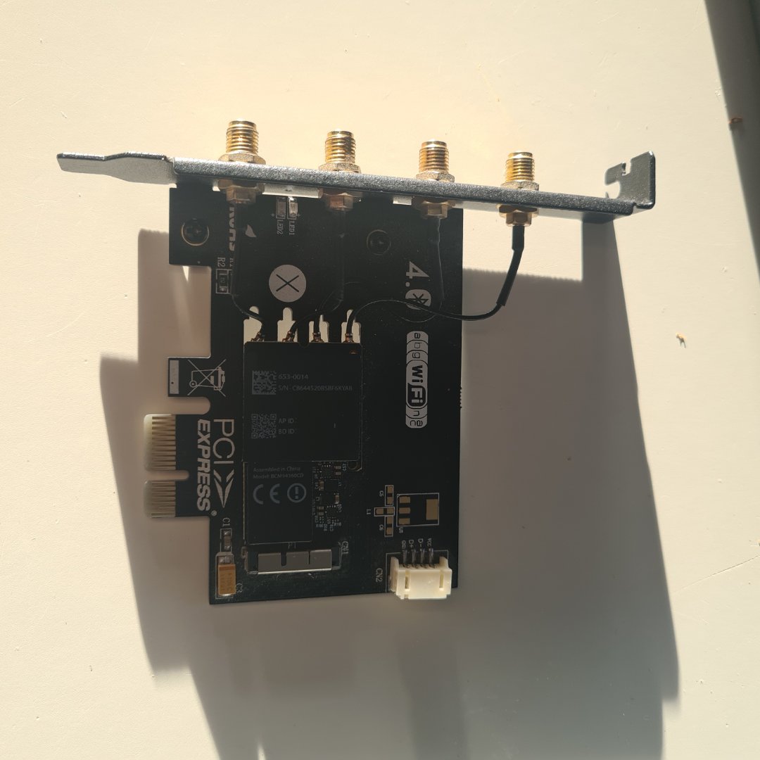

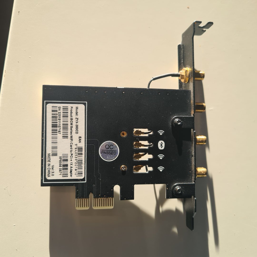

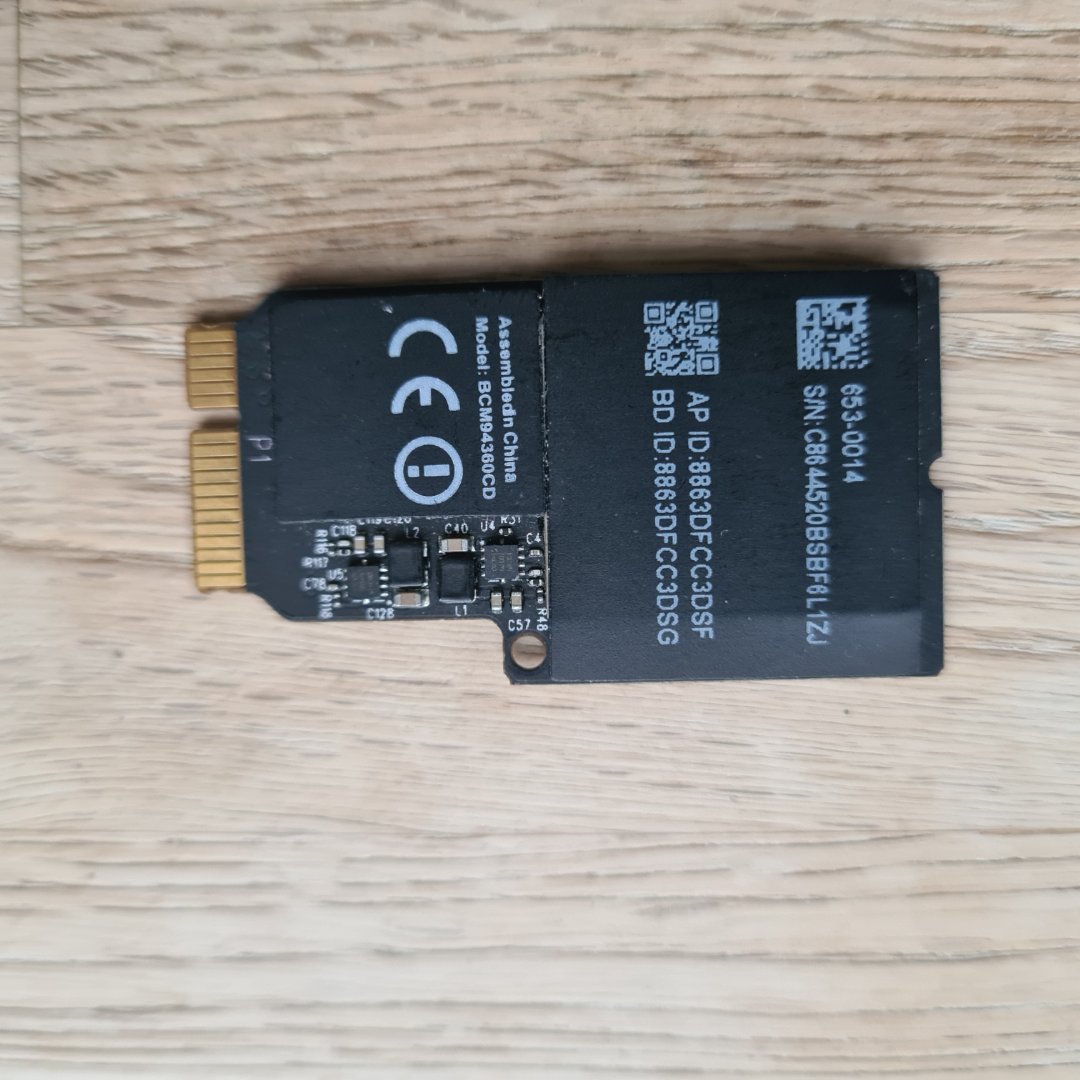

    Ich habe meine Karte mal in den Anhang gepackt. Diese habe ich mit einer PCIe- Adapter Karte verbaut. Unter Monterey lief sie OOB. Unter Sequoia habe ich Wifi mit der Anleitung aus diesen Forum mittels OC Legacy Patcher und den Kexten für Sequoia weiter unten in dem Post an den Start bekommen.
