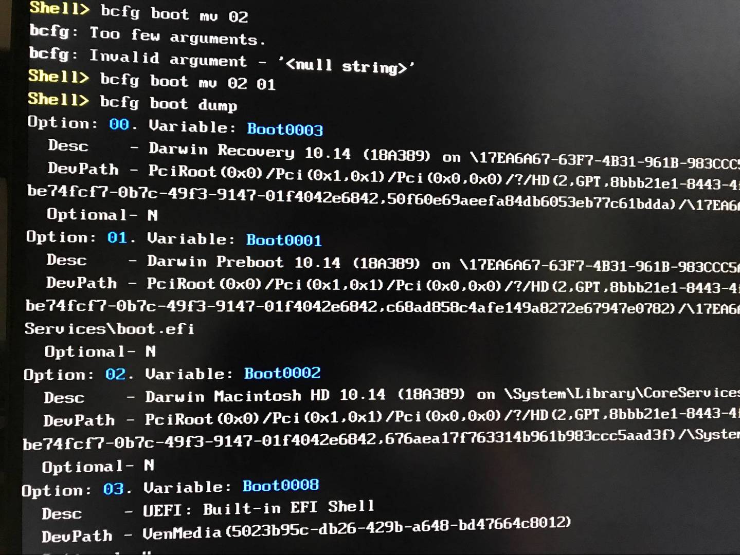

    Did you try it integrated as ffs into your ROM or loaded through bcfg, DBounce or rEFIt?
  • Sorry,my words are too simple.
    I inserted ffs file into bios, and modified the plist file to replace the raw.
    And I tested in 10.13.6 ,it works perfect!
    but in 10.14 beta10,there is a strange problem which can not recognize the major-minor-revision just 0-0-0,
    I doubt this maybe caused by beta version。
    BTW,is there anybody still working on hd4600?when start 10.14, it is stuck at the Apple logo and no progress bar! ;(

  • Its ok man. Looks like we have broken version string parsing with no 'Version.Revision' (eg: "10.14"). It should ok with "10.14.6" for ex. Will fix it soon, thanks for reporting.
