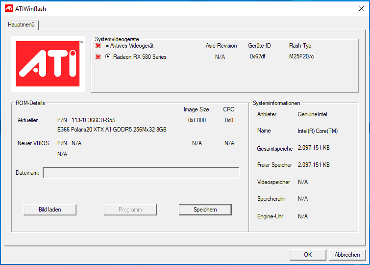

1. Save the original VBIOS of yo RX 470/480/570/580 with ATIWinFlash (download it and save on C: as "ati").
Don't 4get: make an extra copy of the ROM in case somethings will go wrong.
I own a Sapphire RX 580 Nitro+ 8GB.
2. Take note of the part number of yo lovely card, in my case P/N 113-1E366CU-S5S.

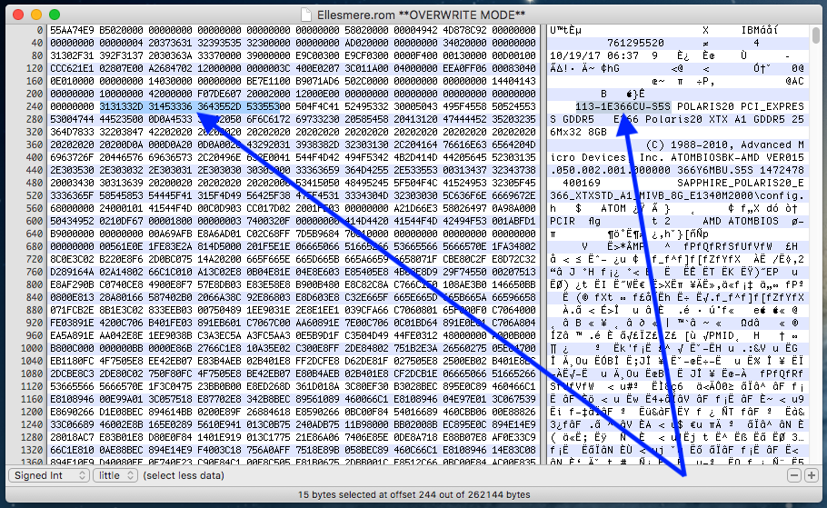

3. Open the VBIOS (rom) of yo card in a Hex Editor of your choice, I used HxD 4 this and search 4 yo P/N.
4. Then replace yo P/N with the desired P/N that macOS identifies as “Radeon RX 580”. I used 113-4E353BU-O4E.

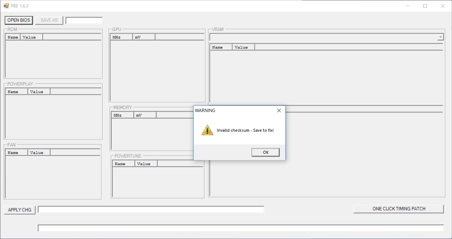

5. The new ROM will have an invalid checksum, so you won’t be able to flash yo card with ATIWinFlash yet.
To cope with that open yo ROM in PolarisBIOSEditor. It will tell U 2 save the VBIOS in order to fix this error.
6. Now simply save yo ROM as... I saved as "bios".

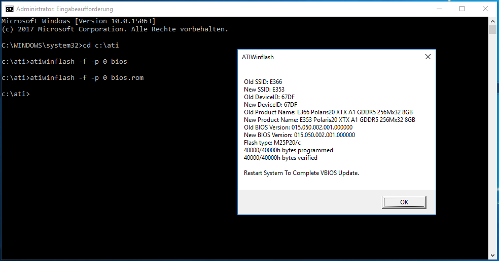

7. Then ask Cortana 4 "cmd", open it as a admin and type what U see on my next screenshot...
8. Now restart yo rig but I prefer the shutdown.
My Sapphire Radeon RX 580 8GB NItro+ do not need anything (WeG, RDI, FB) until macOS High Sierra 10.13.5
