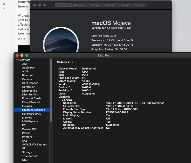

    I could get 14.4 ver 3 to work with 2x VIIs, now I have it with one card and no IGPU. If it was as you say that my IGPU was somehow active I would not get similar results to you in 10.14.4 beta 3. My results are very different in 10.14.4 beta 2.
    test 1. Single card HDMI boot to black screen with cursor in a small square.

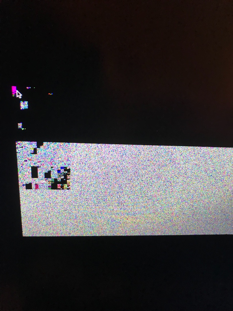

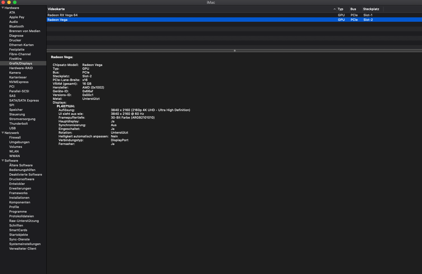

    test 2. Dual cards card one HDMI slot 1, card 2 DisplayPort. card 1 boots t black screen but has small screen with distortions (see pic) card 2 boots to Mojave normal use.
    test3. Boot again and then switch card one HDMI port to diplayports for testing. DisplayPort next to HDMI works. DisplayPort on card 2 works.
    test 4. pull power from card 2 and boot with card 1. Boots normally I'm writing from it now.
    Possible fix for you test DisplayPort next to HDMI port.
    Remember, I have IGPU disabled and have the same black screen issue as you but I may have solved it for 14.4 beta 3.
    Without card 2 I get black screen unless plugged into DisplayPort next to HDMI. This could be a frame buffer assignment issue that affects beta 3 because there is no issue in 10.14.4 beta 2. I only had one card when I successfully tested that version and I still have the disk and confirmed it still works on single card with all ports.

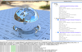

    Luxmark Ball 284 watts peak (fans loud), back to idle 54 watts fans slowing 15 seconds then back to idle 48-50 watts.

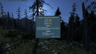

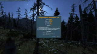

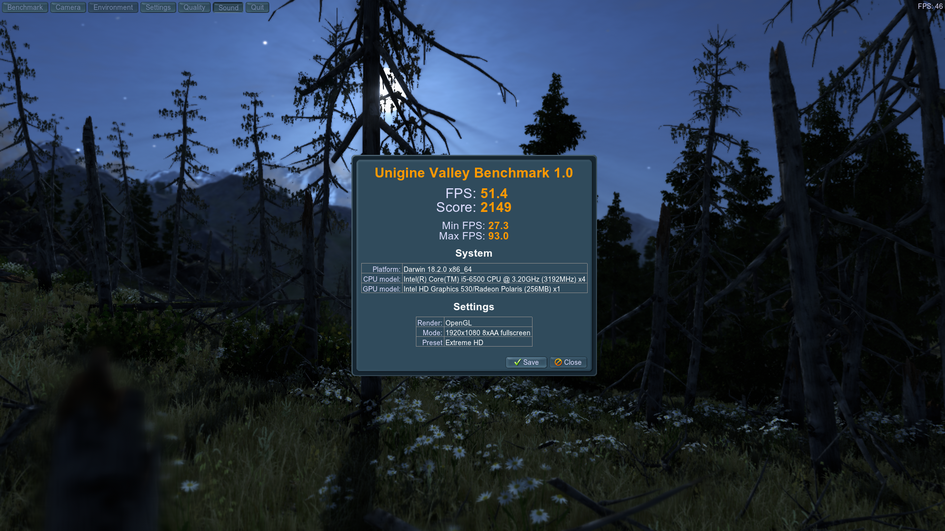

    Uningine Valley, 224-273 watts fans medium noise, then back to idle 15 seconds 48-50 watts.

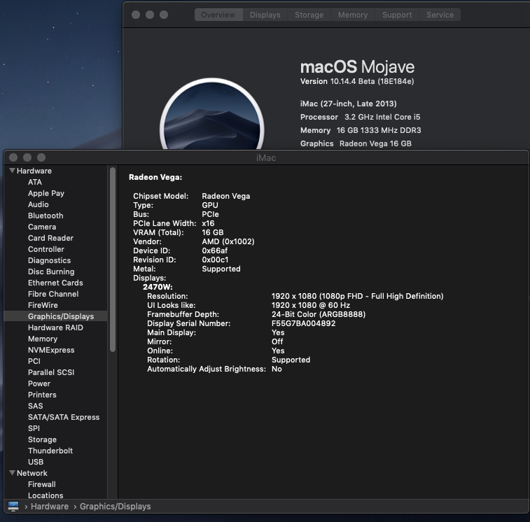

    Radeon VII in Mojave DP 14.4 #2. Metal! Edit AMDRadeon5000kext info.plist for ID. Does not work in 14.3 no acceleration.

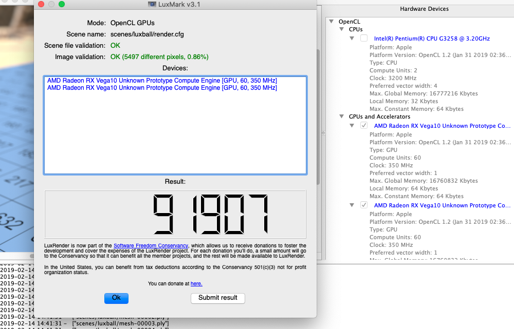

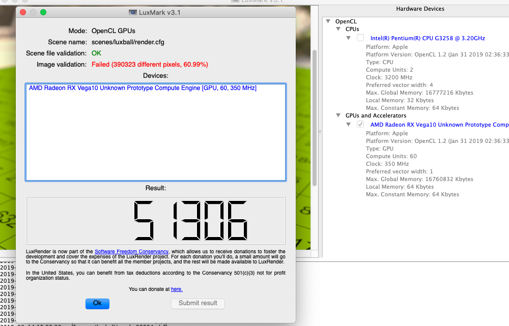

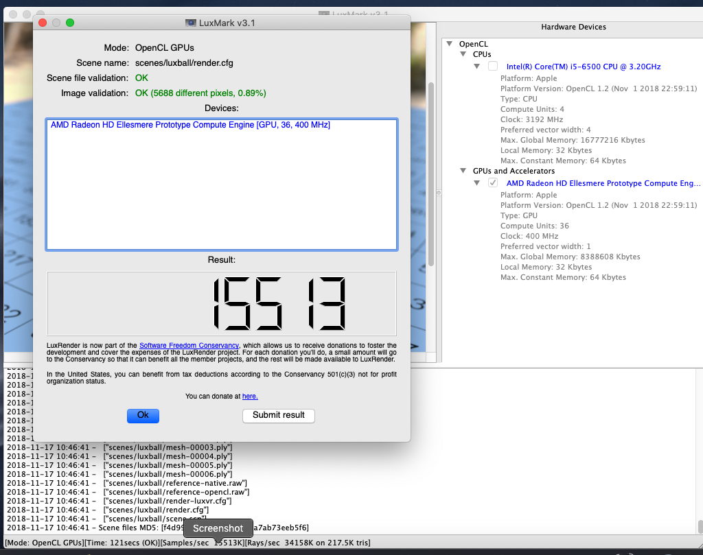

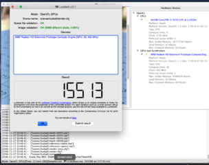

    Strange thing, Luxmark has a green background with single card. With dual cards blue (normal) but one card has bios update from Crimson 19.2 drivers so 1 card UEFI bios other Legacy bios?
    Luxmark before Crimson 19.2 update Legacy bios.
    Luxmark with 2x cards one UEFi other Legacy. Color is normal and no errors.

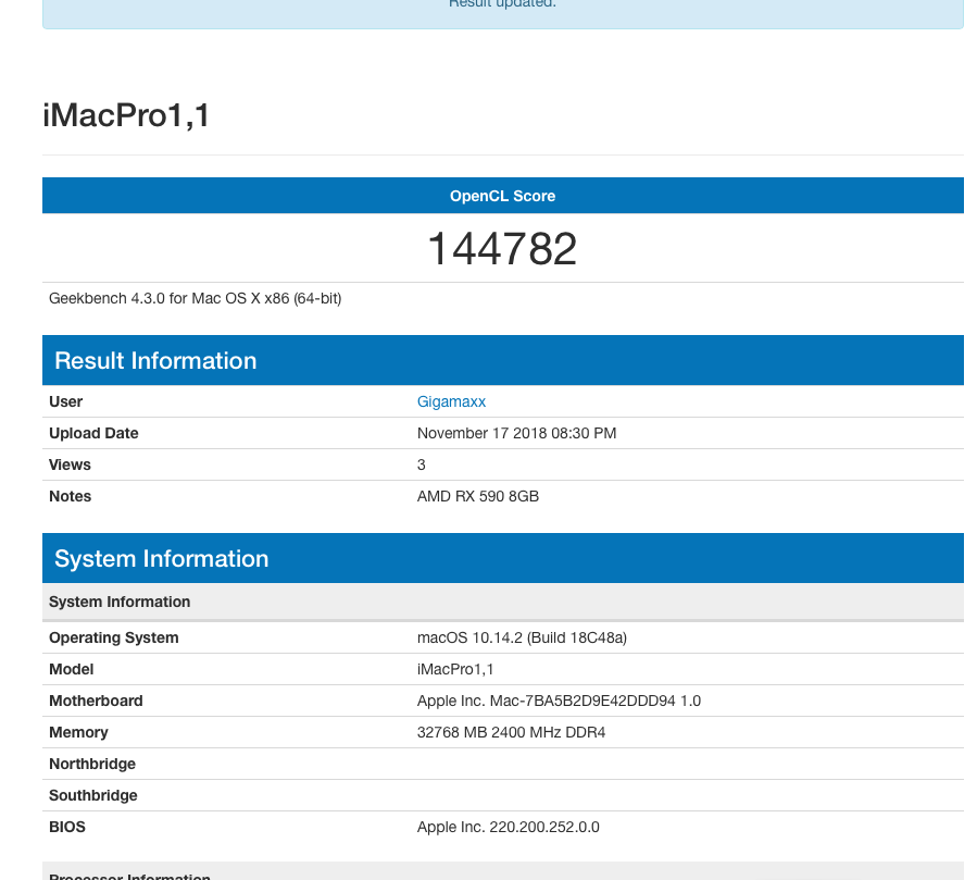

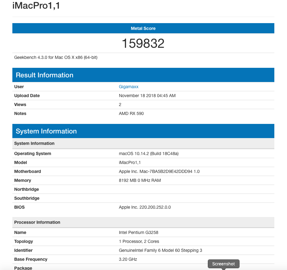

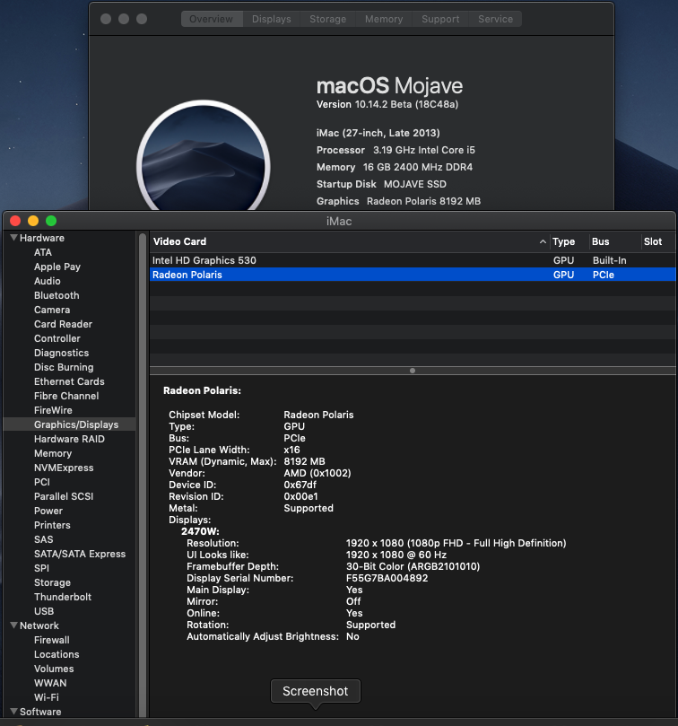

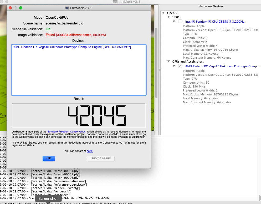

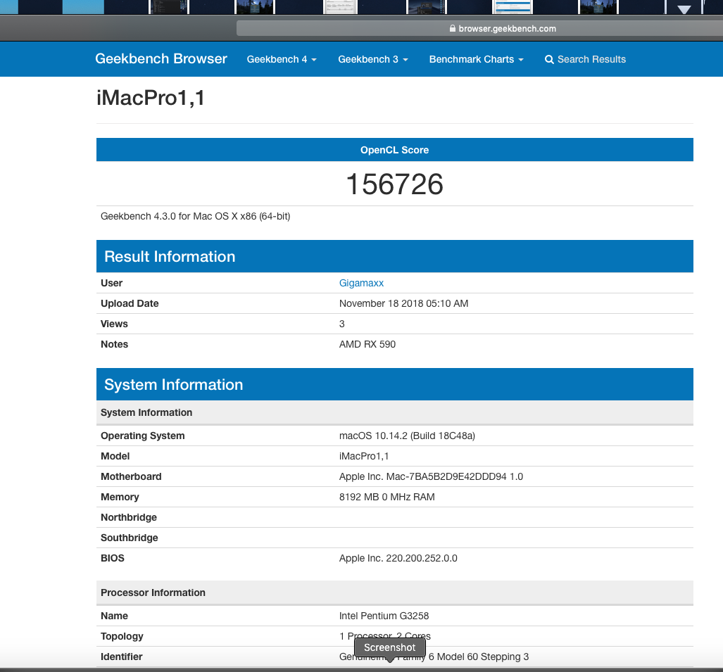

    1. High Sierra ist fehlerhaft, niedrige Benchmarks. Ich werde Mojave 14.1 testen. Bericht zurück, aber ich denke, dass die neuesten Mojave-Treiber notwendig sein könnten.
    2. Mojave 14.2 Beta 3 mit meinem Pentium g3258 und Bios auf OC-Modus umgestellt
    3. <img src="https://www.hackintosh-forum.de/attachment/89310-rx-590-g3258-metal-png/?thumbnail=1" class="woltlabAttachment" data-attachment-id="89310" id="wcfImgAttachment0"><img src="https://www.hackintosh-forum.de/attachment/89311-rx-590-opengl-geekbench-png/?thumbnail=1" class="woltlabAttachment" data-attachment-id="89311" id="wcfImgAttachment0">
