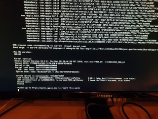

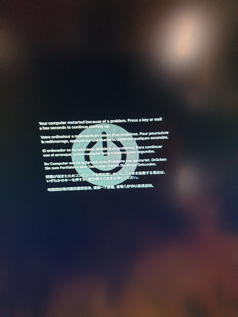

Dann startet der Hackintosh und es kommen dann diese Fehlermeldungen:

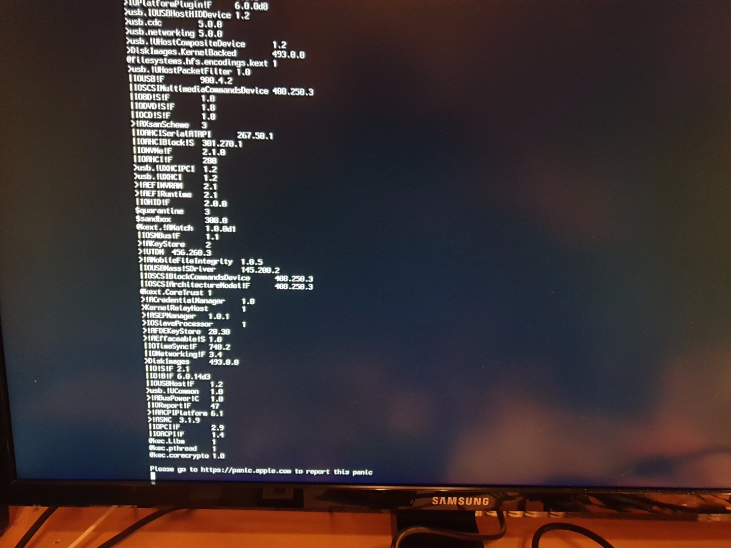

Hier noch der Fehlerbericht:
Anonymous UUID: 84138249-D1BC-C2A9-0AD9-0D33E62A8D93
Mon Mar 16 11:36:03 2020
*** Panic Report ***
panic(cpu 0 caller 0xffffff801c4da29d): Kernel trap at 0xffffff7fa04e4e8f, type 14=page fault, registers:
CR0: 0x000000008001003b, CR2: 0x0000000000000000, CR3: 0x000000003277c000, CR4: 0x00000000003626e0
RAX: 0x0000000000000000, RBX: 0x0000000000000000, RCX: 0x0000000000000001, RDX: 0x0000000000000001
RSP: 0xffffff83a460de50, RBP: 0xffffff83a460de80, RSI: 0x000000006e263e00, RDI: 0x0000000000000000
R8: 0x000000006e263e00, R9: 0x0000000000000000, R10: 0x0000000000000000, R11: 0x0000000000000000
R12: 0x0000000000000001, R13: 0xffffff801cc0c8c0, R14: 0xffffff836468d000, R15: 0x0000000000000000
RFL: 0x0000000000010002, RIP: 0xffffff7fa04e4e8f, CS: 0x0000000000000008, SS: 0x0000000000000000
Fault CR2: 0x0000000000000000, Error code: 0x0000000000000000, Fault CPU: 0x0, PL: 1, VF: 5
Backtrace (CPU 0), Frame : Return Address
0xffffff83a460d920 : 0xffffff801c3aeb0d mach_kernel : _handle_debugger_trap + 0x48d
0xffffff83a460d970 : 0xffffff801c4e8653 mach_kernel : _kdp_i386_trap + 0x153
0xffffff83a460d9b0 : 0xffffff801c4da07a mach_kernel : _kernel_trap + 0x4fa
0xffffff83a460da20 : 0xffffff801c35bca0 mach_kernel : _return_from_trap + 0xe0
0xffffff83a460da40 : 0xffffff801c3ae527 mach_kernel : _panic_trap_to_debugger + 0x197
0xffffff83a460db60 : 0xffffff801c3ae373 mach_kernel : _panic + 0x63
0xffffff83a460dbd0 : 0xffffff801c4da29d mach_kernel : _kernel_trap + 0x71d
0xffffff83a460dd40 : 0xffffff801c35bca0 mach_kernel : _return_from_trap + 0xe0
0xffffff83a460dd60 : 0xffffff7fa04e4e8f com.apple.driver.AppleIntelCFLGraphicsFramebuffer : __ZN31AppleIntelFramebufferController16ProcessInterruptEv + 0xe3b
0xffffff83a460de80 : 0xffffff7fa04c5045 com.apple.driver.AppleIntelCFLGraphicsFramebuffer : __ZN31AppleIntelFramebufferController18HWInterruptHandlerEP28IOFilterInterruptEventSource + 0x25
0xffffff83a460dea0 : 0xffffff801ca5c6a5 mach_kernel : __ZN28IOFilterInterruptEventSource23normalInterruptOccurredEPvP9IOServicei + 0x55
0xffffff83a460dee0 : 0xffffff7f9cd09a3e com.apple.iokit.IOPCIFamily : __ZN32IOPCIMessagedInterruptController15handleInterruptEPvP9IOServicei + 0x124
0xffffff83a460df30 : 0xffffff7f9d26aa7c com.apple.driver.AppleACPIPlatform : __ZN23AppleACPIPlatformExpert23dispatchGlobalInterruptEi + 0x42
0xffffff83a460df50 : 0xffffff7f9d273aa5 com.apple.driver.AppleACPIPlatform : __ZN31AppleACPICPUInterruptController15handleInterruptEPvP9IOServicei + 0x6b
0xffffff83a460df70 : 0xffffff801c4d982c mach_kernel : _interrupt + 0x14c
0xffffff83a460dfd0 : 0xffffff801c35be4d mach_kernel : _hndl_allintrs + 0x11d
0xffffff83c46ebf30 : 0xffffff801c3ce747 mach_kernel : _processor_idle + 0xf7
0xffffff83c46ebf80 : 0xffffff801c3cedd0 mach_kernel : _idle_thread + 0x20
0xffffff83c46ebfa0 : 0xffffff801c35b0ce mach_kernel : _call_continuation + 0x2e
Kernel Extensions in backtrace:
com.apple.iokit.IOPCIFamily(2.9)[5C9A453F-559B-3683-9E81-D288D13A33CE]@0xffffff7f9cceb000->0xffffff7f9cd1ffff
com.apple.driver.AppleACPIPlatform(6.1)[E44E285D-01ED-3E8B-A21D-FC792AFC9DB9]@0xffffff7f9d263000->0xffffff7f9d2fefff
dependency: com.apple.iokit.IOACPIFamily(1.4)[67079254-1B34-31D2-8C7B-B138E26BFDD8]@0xffffff7f9cce2000
dependency: com.apple.iokit.IOPCIFamily(2.9)[5C9A453F-559B-3683-9E81-D288D13A33CE]@0xffffff7f9cceb000
dependency: com.apple.driver.AppleSMC(3.1.9)[4523E39C-6A5A-3352-BE3B-2B3BD9B70251]@0xffffff7f9cd71000
com.apple.driver.AppleIntelCFLGraphicsFramebuffer(12.0.4)[62299C05-41B5-3538-AAC5-C53551ADEB7E]@0xffffff7fa0497000->0xffffff7fa06b9fff
dependency: com.apple.iokit.IOAcceleratorFamily2(404.2.2)[3F0DBC5F-414B-379E-8C7B-A2F50B278A2A]@0xffffff7fa03e9000
dependency: com.apple.iokit.IOReportFamily(47)[5F165AE5-F4F2-3415-857C-34F2462A730E]@0xffffff7f9ccdb000
dependency: com.apple.AppleGraphicsDeviceControl(3.28.4)[E80DEB91-2401-31C2-901F-CA63B4342337]@0xffffff7fa048e000
dependency: com.apple.iokit.IOGraphicsFamily(530.14)[D44517BE-2B53-3BD5-826E-4E78B55E3B73]@0xffffff7fa039e000
BSD process name corresponding to current thread: kernel_task
Boot args: -v dart=0 darkwake=10 keepsyms=1 debug=0x100 root-dmg=file:///Install%20macOS%20Mojave.app/Contents/SharedSupport/BaseSystem.dmg
Mac OS version:
18D109
Kernel version:
Darwin Kernel Version 18.2.0: Thu Dec 20 20:46:53 PST 2018; root:xnu-4903.241.1~1/RELEASE_X86_64
Kernel UUID: 1970B070-E53F-3178-83F3-1B95FA340695
Kernel slide: 0x000000001c000000
Kernel text base: 0xffffff801c200000
__HIB text base: 0xffffff801c100000
System model name: MacBookPro11,4 (Mac-06F11FD93F0323C5)
System uptime in nanoseconds: 103575422780
last loaded kext at 103106933513: com.apple.driver.AppleGraphicsDevicePolicy 3.28.4 (addr 0xffffff7fa0b84000, size 77824)
last unloaded kext at 62149735634: ru.usrsse2.SMCLightSensor 1 (addr 0xffffff7f9ffc4000, size 16384)
loaded kexts:
(none)
EOF

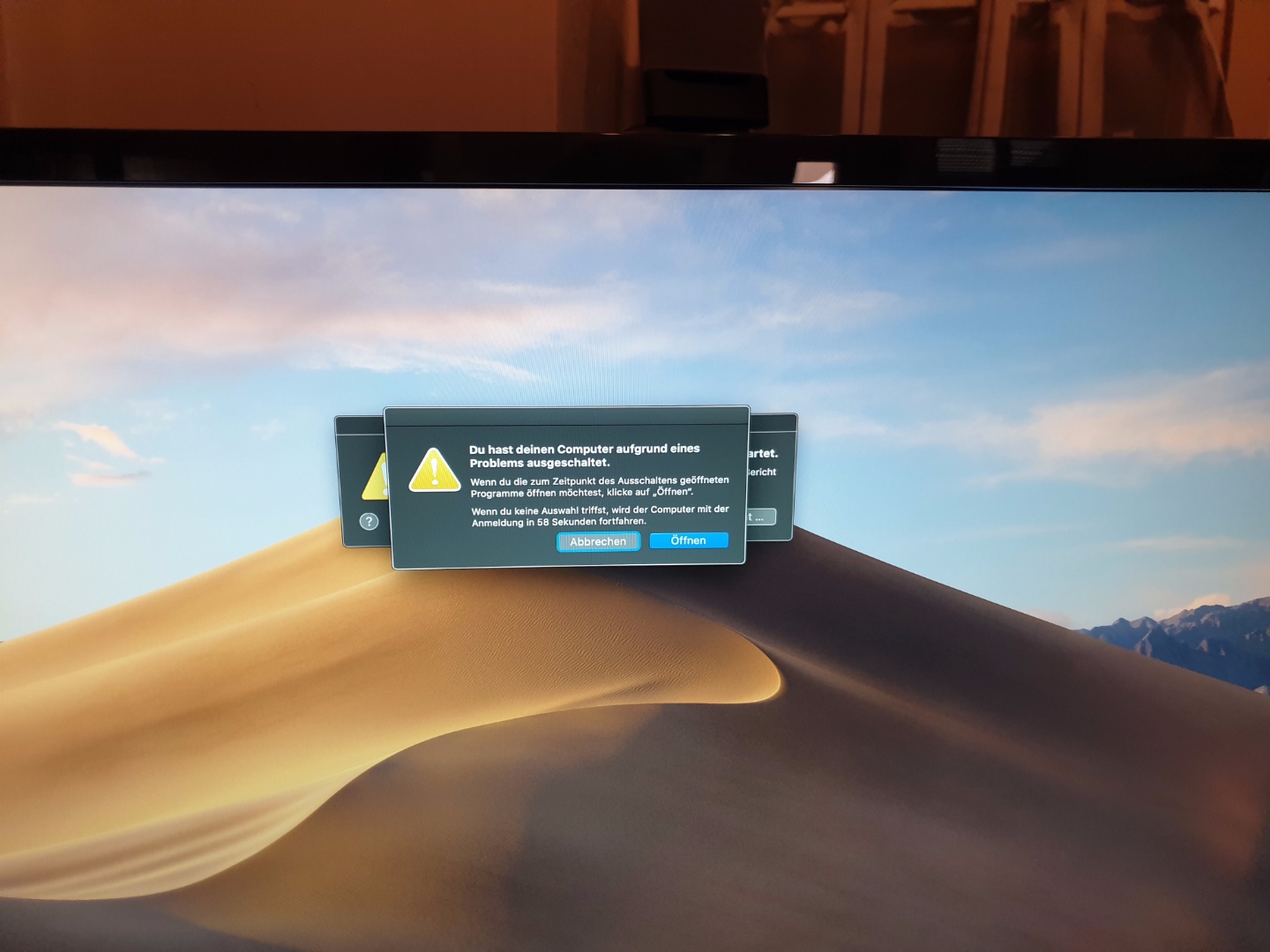

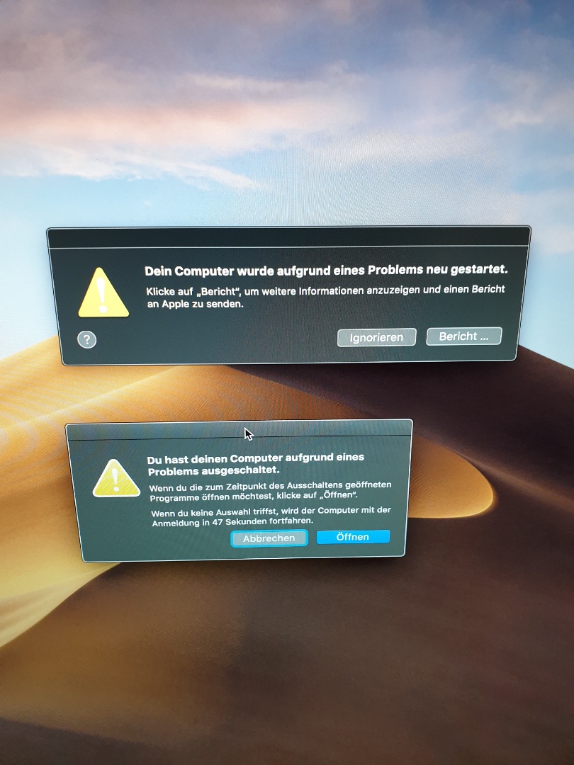

jetzt bin ich endlich wieder aus dem Krankenhaus und habe versucht, meine Grafikkarte zum Laufen zu bringen. Leider ohne Erfolg.
Ich habe die ASUS AREZ RX 570 also eingebaut und unter Windows 10 erstmal angetastet, ob sie überhaupt geht. Funktioniert einwandfrei unter Win10. Im UEFI BIOS habe ich dann umgestellt auf interne Grafik, damit ich den Hackintosh entsprechend konfigurieren kann. Leider ist das System gar nicht mehr gestartet.
Ich hänge mal die Fehlermeldungen an.
