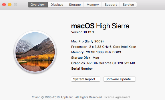

8-core: Two 2.66GHz Quad-Core Intel Xeon 5500 processors upgrade to 12-core: Two 3.33GHz Quad-Core Intel Xeon 5680 processors
IHS removed

I am thinking later on to upgrade to 2 x X5690 six cores and add ram in sum of 64, not more.

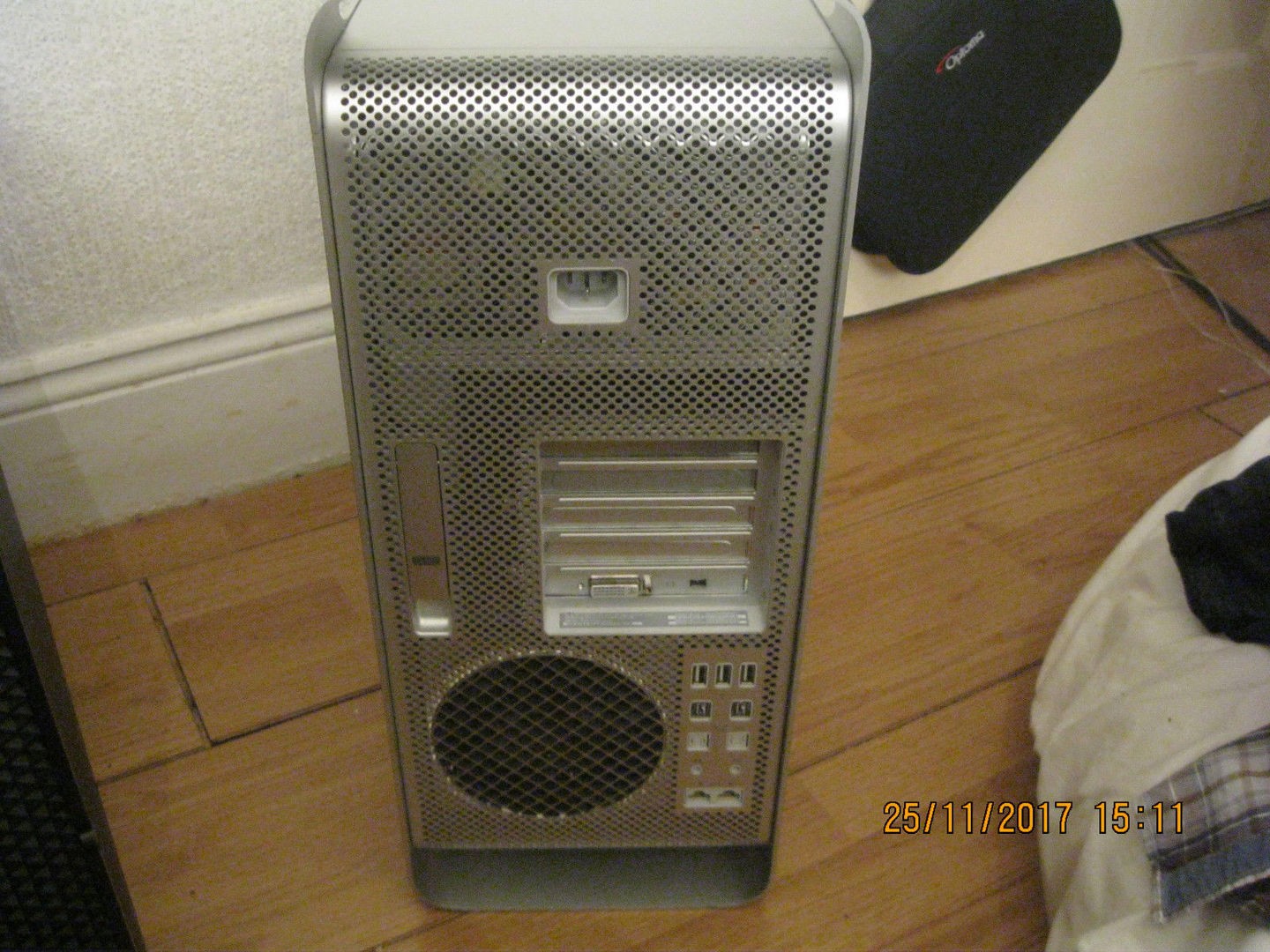

After researching, a week ago i bought Mac Pro 4.1 year 2009 from UK. It cost Me about 530 Euros with postage.
I was looking only for Mac pro 4.1 and 5.1 and only with two processor slots due to the capability of upgrade in the future.
Mac 4.1 on the fifth part is cheaper then 5.1, and Mac 4.1 can be firmware updated to 5.1 due to the same hardware inside it.
Specification are:
Mac Pro (Early 2009) 4.1
Memory: 4gb
NVIDIA GeForce GT 120 with 512MB of GDDR3 memory
HDD: 500GB with El CapitanUpgrade will be updated soon!
