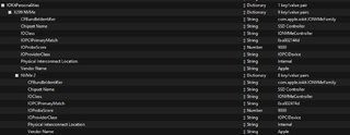

  • So not more DSDT patch is required like i am using the following patch.
    With your kext, if i have many NVME Drive can i add just like this ?
    Images
  • can i add just like this ?
    Of course. In the example you see two addresses, only separated by a space:
    It can be specified as many as you like.
