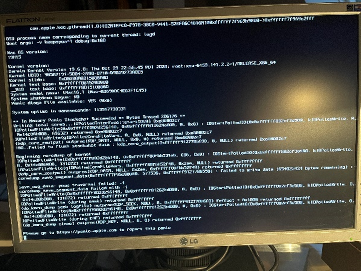

  • Thanks for the quick reply. I made several tests and they all finish with stall after installing on SSD and reboot.
    I;E; with Catalina, I succeeded with the boot from USB, I've been able to create a partition and to copy the files (install) but after the reboot, I fall in the following traces
    which all end with a Kernel Panic
    The same if I try to install other versions.
    I was wondering if the problem could come from the BIOS version or settings. I have a S/N wich ends with PRO-V23. I actually have the factory version installed and I could update bios if necessary to EC_VB1002 or EC_VB1003.
    I understood that the EFI with the config.plist and OC folder was already functional for any U55 but if it is not the case (and I have to update the plist.config can you share some guide or tools?. Any suggestion about the cause of the error I am facing?
    Best Regards,
    M.ilan

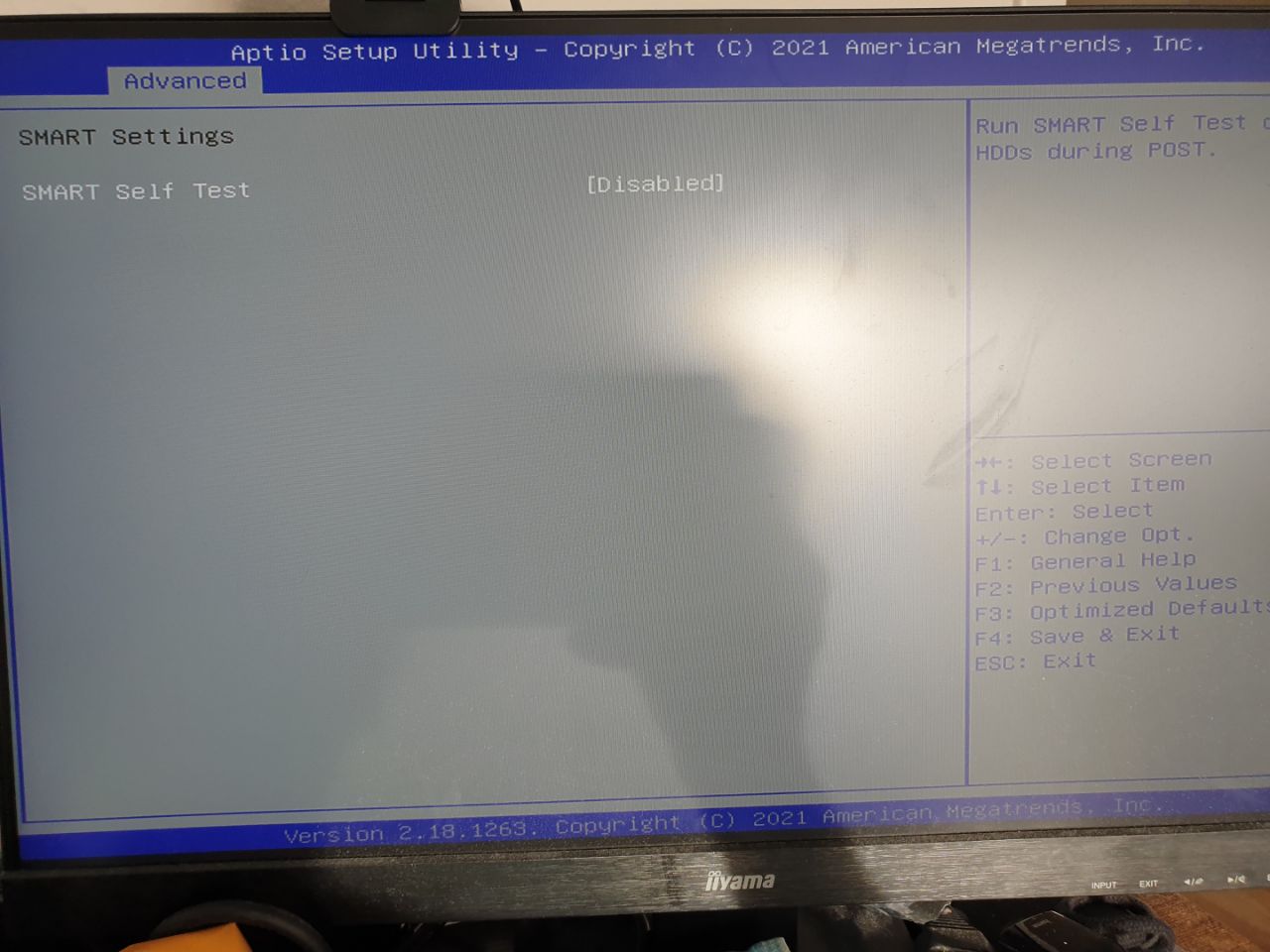

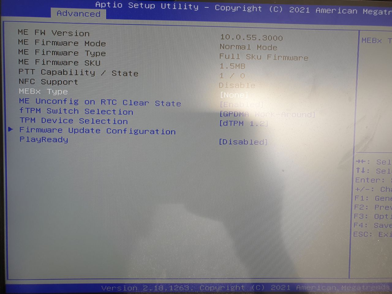

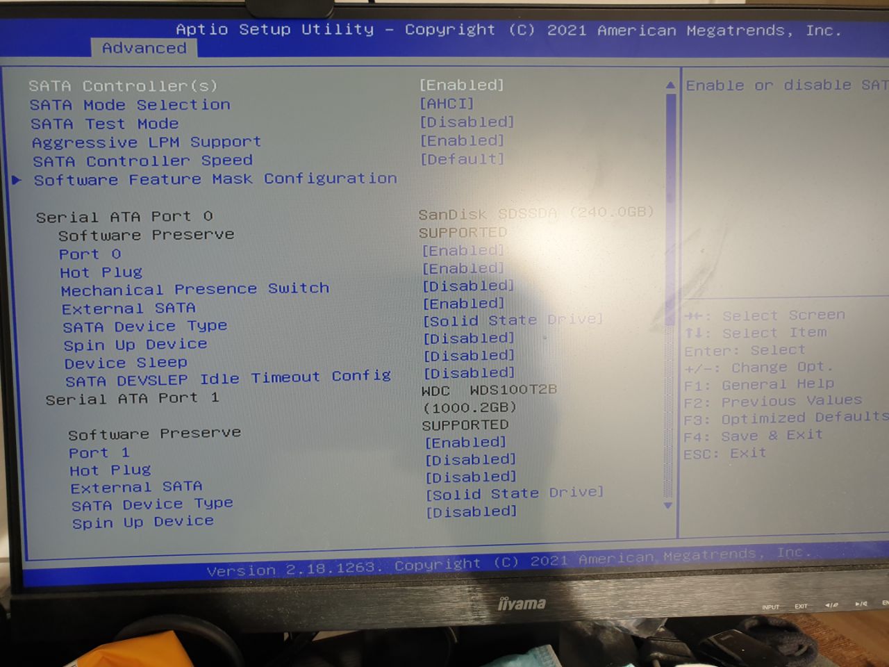

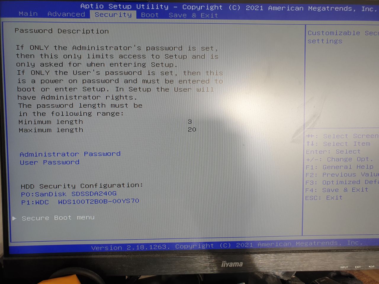

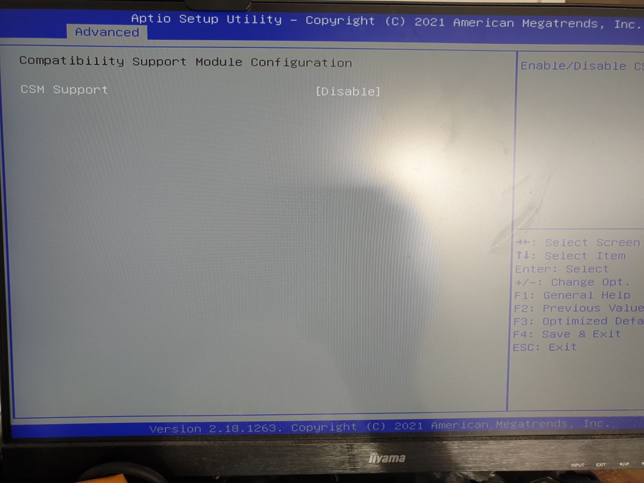

  • Hello again, i have the same system and the bios will not play a role. i had a lot of problems with ssd because they was never found in bios. I changed the wire to a 12pin 0.5p straight one and since this i can boot. from ssd. My Bios is
    VB1003.rar2021-03-31591.29KB
    Please note that this EC is only applicable to U55, and the SN code of the machine bottom shell are U55-A-XXXXUD0W64RPO-V22 and U55-A-XXXXUD0W64RPO-V23, please do not use it on other computers.
    This version of EC can realize the automatic power-on function
    from the Bee-Link Page.

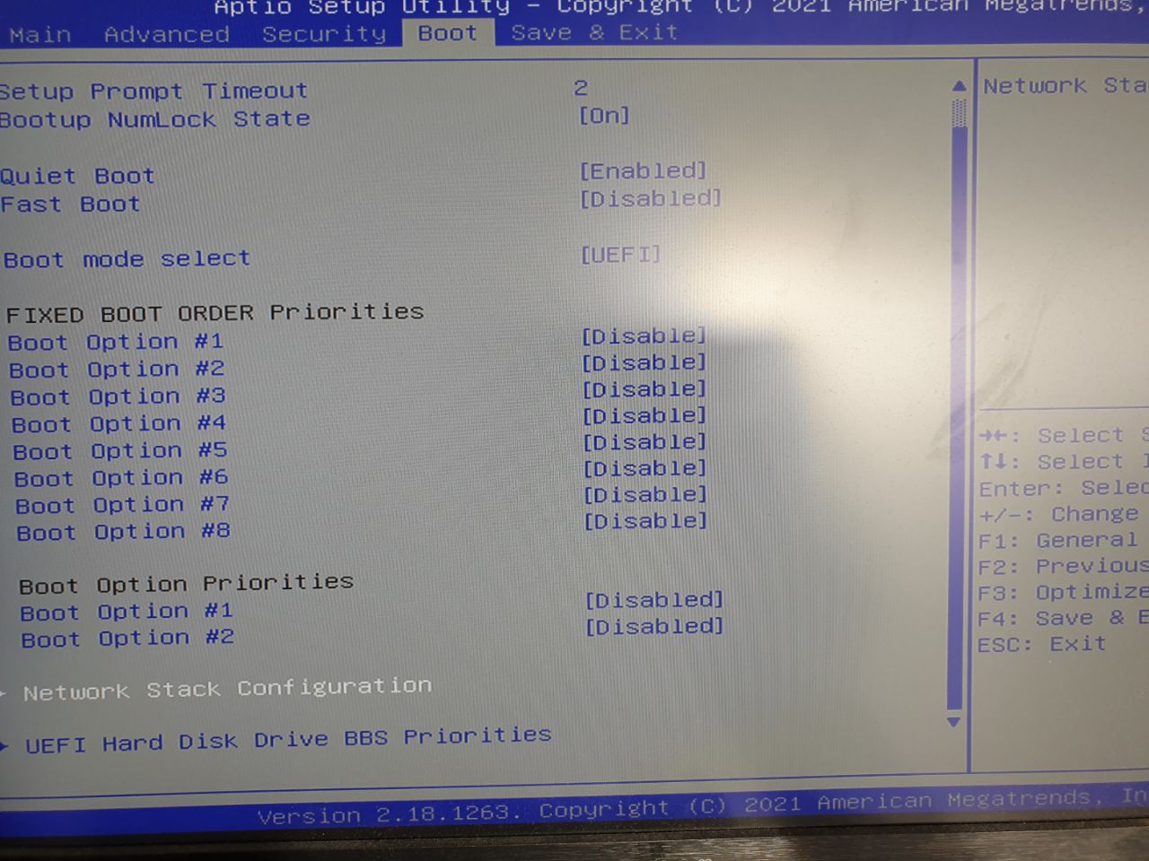

    In BIOS, Secure Boot must be disabled And Boot. Mode must be UEFI.

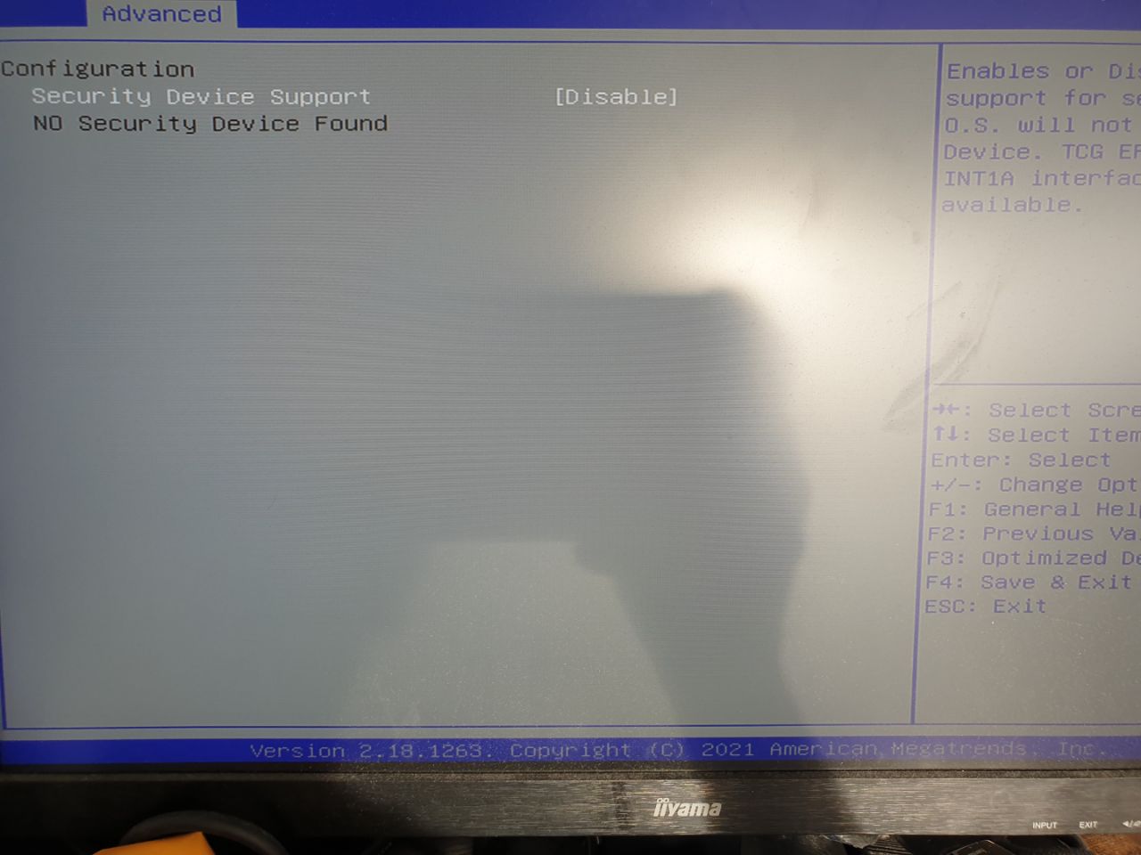

    Here are most of my settings:
